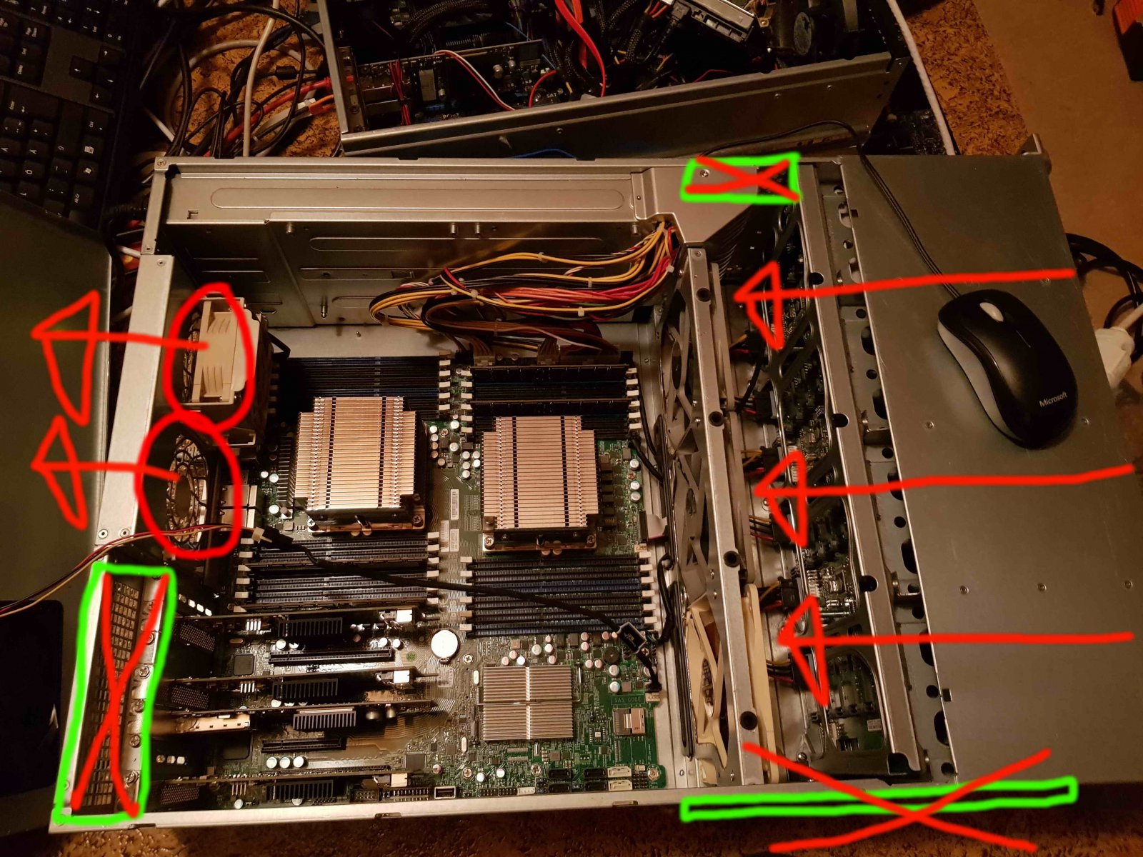

i decided to rebuild my Supermicro build so i can actually have in the house.
the way forward is silent but also cool
these 2 things do not go hand in hand though :-(
I have 2 main questions
1: CPU cooler vertical or horizontal
2: push in air from the top or suck it out ?

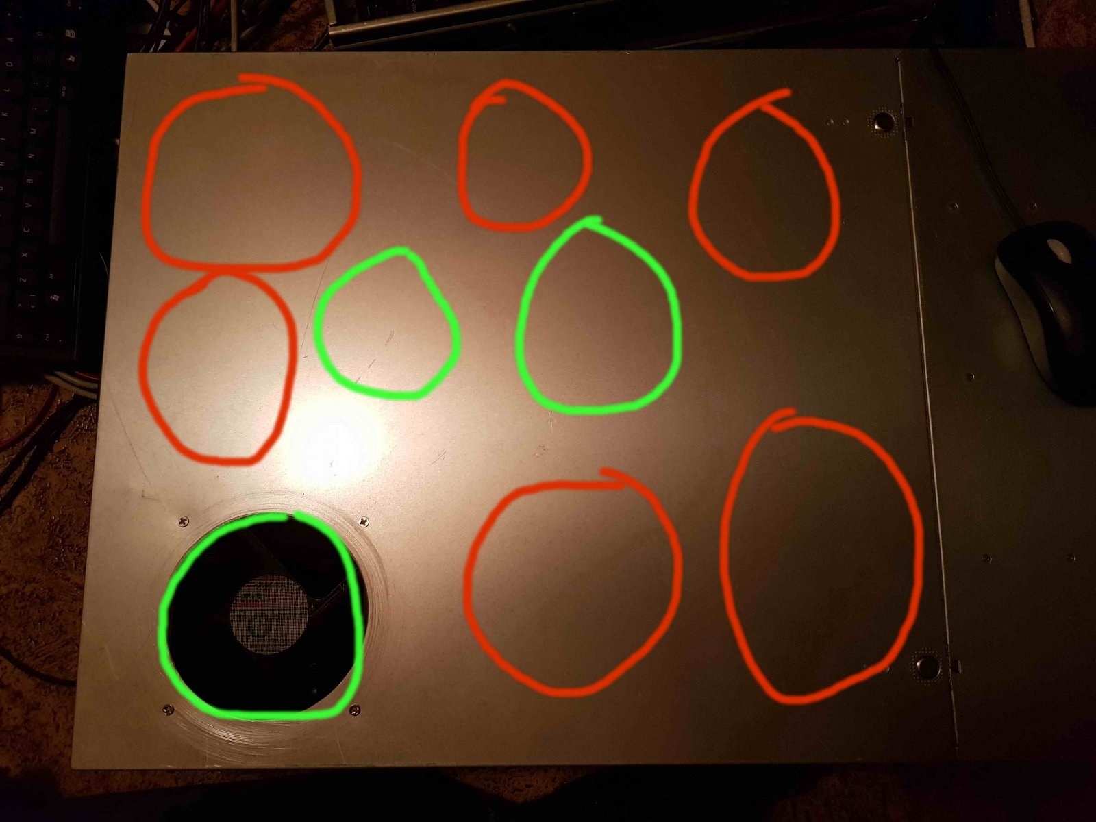

i am going to install fans in the lid to either push in or suck our air or both.

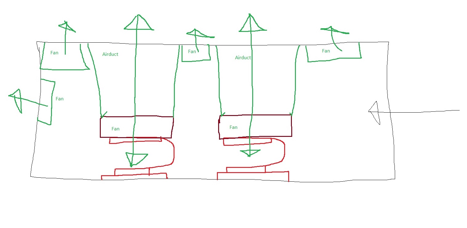

i am thinking about cutting 2 holes center above the CPU coolers and then use a duct to get cool air to the CPU and then have maybe 4-6 fans spred out over the lid to such out the air
i want the air to go from the front via the HDD bays in to the main compartment of the chassis
i will scose off all extra vent holes with tape

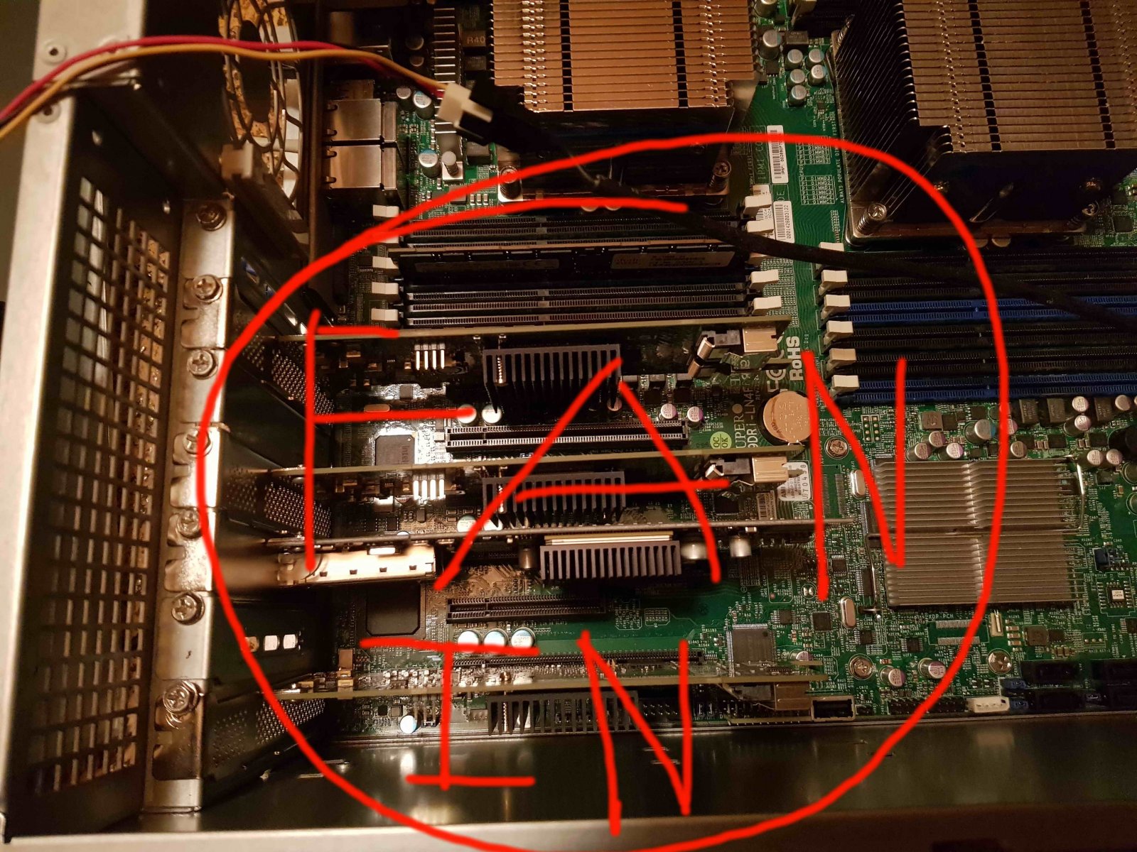

i have one fan installed right above the LSI's blowing air in to cool them, or should i suck out and then have a duch under the fan to maximize the flow over the cards?

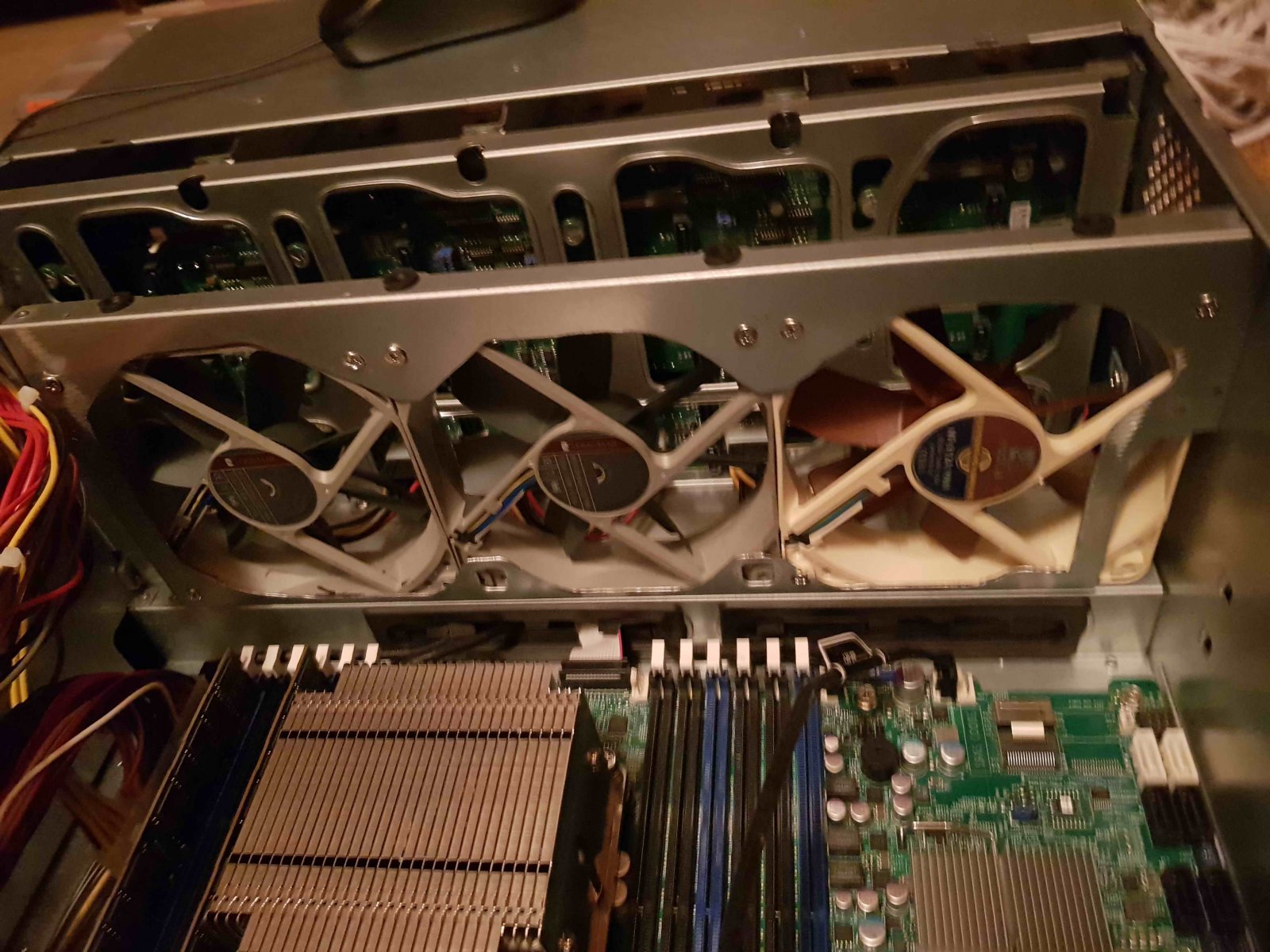

i have already installed 3X120 fans behind the Backplane but it is not enough
before i did anything to my chassis i had 42 C MAX and now i have 76 after 2 min of idle so i have to do something to cool my CPU's :-(
any thoughts ?

Those fans you have are not going to work. They are high air flow fans not static pressure. Any time you have to draw air through thing you need static pressure. To pull air through those hdd bays and backplane will require static pressure. If you want your cpu temps to go down you need to get the plastic shroud for that server or get a cpu cooler with a fan.
The loudest thing in that server even with the stock fans is the power supply. Unless you fat the quiet certain if the power supply.

Wow. You really should not replace the factory fans in the Supermicro chassis. The engineers that design those things know what they are doing when it comes to keeping the drives cool, which is an important factor of why the fans are the way they are.
As for the CPUs, you will need to change from passive coolers to active (with fans) coolers
Take a look at this forum post :
ghetto acoustic by @jgreco
https://forums.freenas.org/index.ph...-mb-cpu-hds-recommendations.24453/post-255614
Most of the sound generated by the server is high pitched and easily muffled with sound deadening panels.
