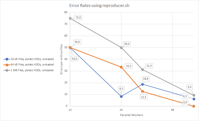

I'm waiting for the final set of results from the fast system before sharing the full dataset. For now, I wanted to share the quick overview of results from my "potato" system, which combines a decently fast server with the crappiest, slowest HDDs I have had the misfortune of dealing with: The Toshiba L200 2.5" laptop SMR 2 TB HDD, attached to a Dell HBA330 Mini/LSI SAS3008 HBA.
The server proper is a Dell R6515 with a single Epyc 7543P CPU, 512 GB of DDR4-3200, running Ubuntu 22.04 with Linux 6.2. The tests were all run with cp 9.4.
I believe this is the worst-case scenario I tested, slightly ahead of the fast system bogged down by CPU busywork, so take these numbers with a big spoonful of salt. I do not claim anyone has seen, will see or could see these error rates in a real workload on a realistic machine. This is basically just a rough indication of what scenarios are more susceptible to hitting this bug - to the two people in the room running SMR laptop drives on their servers, my condolences. I especially want to highlight that the results for the fast system will be different - the 64 kB scenario is the worst one there, for instance.
The full data will be available later, but each data point corresponds to 60 000-640 000 files written, depending on the number of workers. The data points are at 12, 24, 32 and 64 workers (out of 32 physical cores).
By the way, questions on the test methodology and related matters are also welcome in advance.
