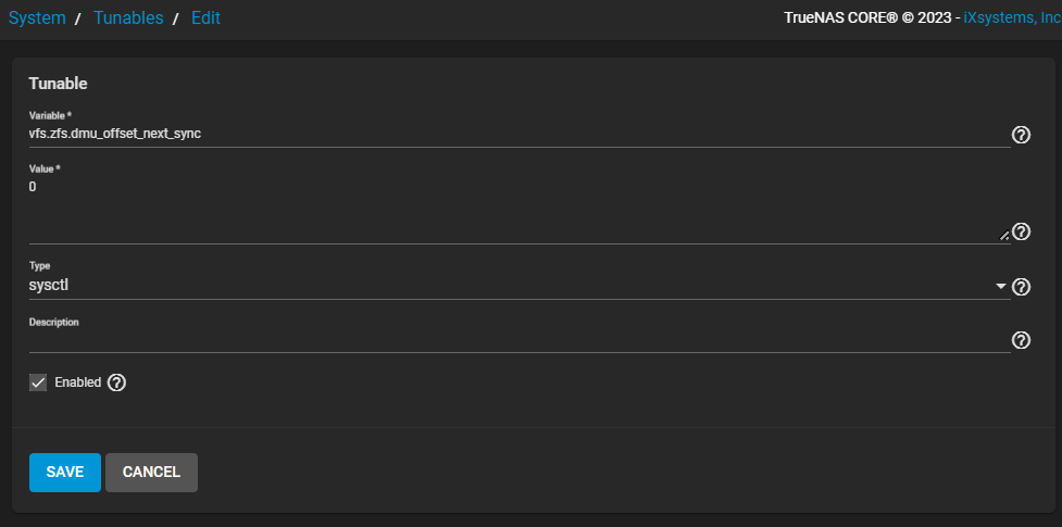

Home user here.
I read this thread and I am confused If I have to do something.
I am on Core 13.0-U5.3 and from the posts here I think I have to apply the tunable change as above.
On the other hand if this so critical, why there is no update that includes this change or at least some bold recommendation on the TrueNAS site?
I am reluctant to change things by hand because I don't know for how long they are valid and if things change maybe I will not be aware of it.
The FreeBSD bug report is suggesting an announcement to inform users to change this variable. (Not sure if it will be the default.)
The tunable practically eliminates the risk outright, and can yield a performance boost under some circumstances. The only "drawback" is less efficient handling/hole-seeking on sparse ("holey") files. Yet it does not violate anything. In fact, prior to OpenZFS 2.1.5, this parameter was already set to 0 by default. From OpenZFS 2.1.5+, they set it to 1 by default. (So it's not as if you're doing anything drastic.)
(Personally, I don't care about how efficiently sparse files are handled: I don't use iSCSI or VMs, and as far as "really 'holey' files" go, inline ZFS compression makes that a non-issue.)
For TrueNAS Core, to set this parameter is fairly simple:

it’s easy enough to set the tunable, then apply the system update to U6. That ensures a persistent fix and the reboot cements the change.

Adding zfs_dmu_offset_next_sync to sysctl on TrueNAS Gui returned Sysctl 'zfs_dmu_offset_next_sync' does not exist in kernel.
I initially did the same thing. On TrueNAS SCALE you add it in GUI under System Settings > Advanced, but *not* under Sysctl but rather in Init/Shutdown Scripts.
Description: Prevent ZFS silent corruption bug - NAS-125358
Type: Command
Command: echo 0 >> /sys/module/zfs/parameters/zfs_dmu_offset_next_sync
When: Pre Init
Enabled ticked
Timeout: 10
Well that's what works for me. You can also run the command "echo 0 >> /sys/module/zfs/parameters/zfs_dmu_offset_next_sync" on the TrueNAS SCALE CLI so you don't have to reboot. If given the opportunity I'd reboot just to make sure that variable setting is working post reboot. Check with "cat /sys/module/zfs/parameters/zfs_dmu_offset_next_sync" should return "0".
SGr33n
Nov 20, 2023
Tnx for your support. Modifying /sys/module/zfs/parameters/zfs_dmu_offset_next_sync to have 0 value didn't work (returned to 1 on reboot). I didn't try
sudo midclt call system.advanced.update '{"kernel_extra_options": "zfs.zfs_dmu_offset_next_sync=0"}'
, I will try, but how to restore it to the default value once the 23.x branch will have ZFS 22.21? Is it
sudo midclt call system.advanced.update '{"kernel_extra_options": "zfs.zfs_dmu_offset_next_sync=1"}'
