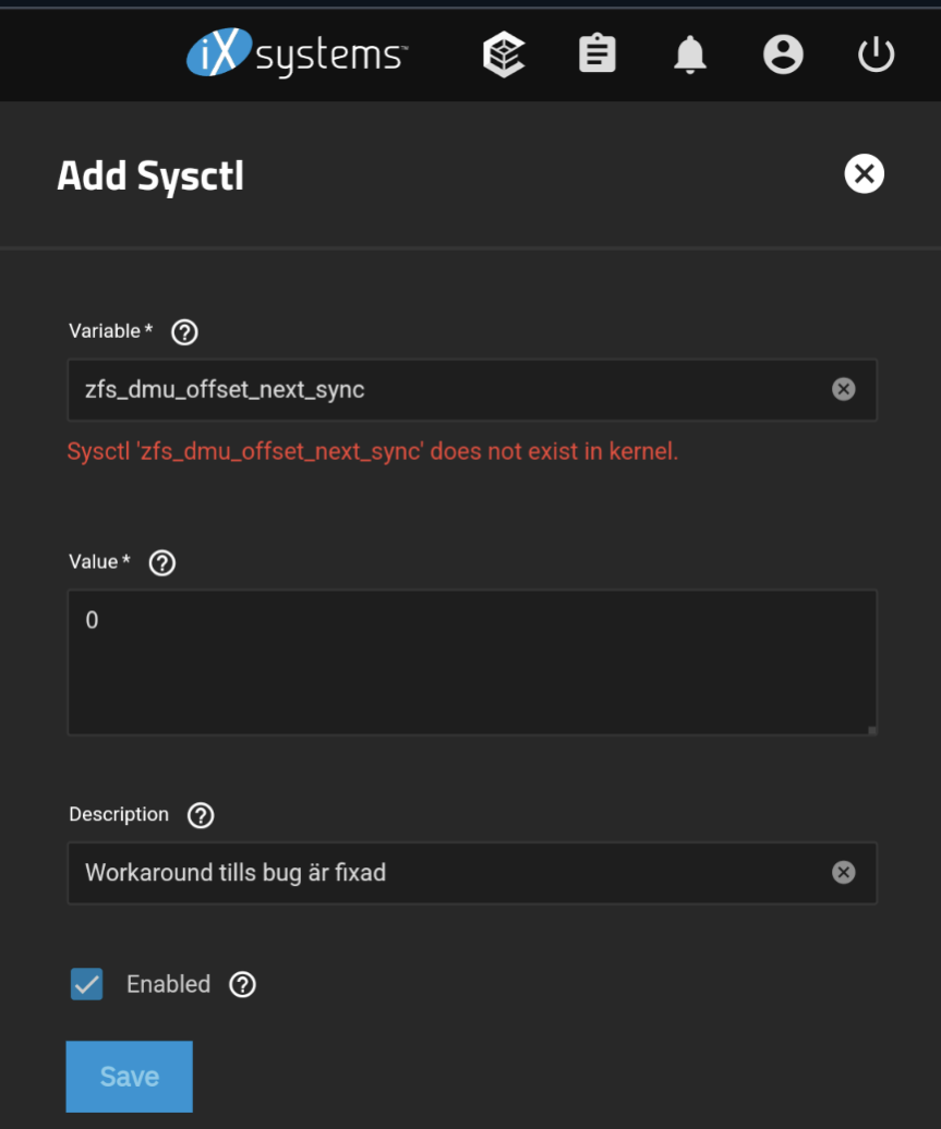

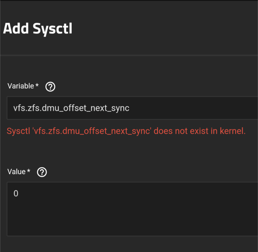

Feb 25, 2023
211
@axhxrx and others, you should use the GUI options below to persist this change across reboots:
CORE: Using System -> Tunables, add
  • Variable: vfs.zfs.dmu_offset_next_sync
  • Value: 0
  • Type: sysctl
SCALE: Using System -> Sysctl, add
  • Variable: zfs_dmu_offset_next_sync
  • Value: 0
Doesn't seem to work.

probain
Feb 25, 2023
211

probain
Feb 25, 2023
211
Just to be clear, you are on SCALE? If so, it's not a sysctl that you need to set, but rather a kernel module parameter.
I was following the instructions posted by @HoneyBadger
They don't seem to be correct though
I have actually applied this in another way. Just informing that the instructions posted don't work.
bcat
Oct 20, 2022
84
Right, I think there is no sysctl for this option on Linux, but rather a parameter for the ZFS kernel module. So adding this via the sysctl list in the TrueNAS UI won't work on SCALE.
To set these in SCALE in a way that takes effect as soon as the module loads and persists across upgrades/reinstalls, you can set the kernel_extra_options "advanced setting" via the TrueNAS API. (On other Linux systems, this could be done through /etc/modprobe.d instead of the kernel command line, but I would assume /etc/modprobe.d is wiped on updates, so going through the TrueNAS API seems safer.)

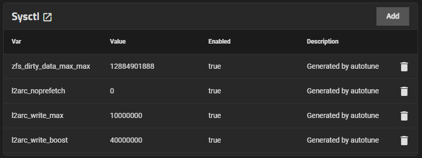

HoneyBadger
actually does care
Administrator
Feb 6, 2014
5,112
Thanks for the heads up. The GUI method definitely should be working as that's where several other tunables live (and do take effect) but perhaps something's amiss. (And yes, it still shows them as "sysctl" despite it being "kernel parameter" on Linux.)
root@mini-r[~]# cat /sys/module/zfs/parameters/zfs_dirty_data_max_max \
> /sys/module/zfs/parameters/l2arc_noprefetch \
> /sys/module/zfs/parameters/l2arc_write_max \
> /sys/module/zfs/parameters/l2arc_write_boost
12884901888
0
10000000
40000000

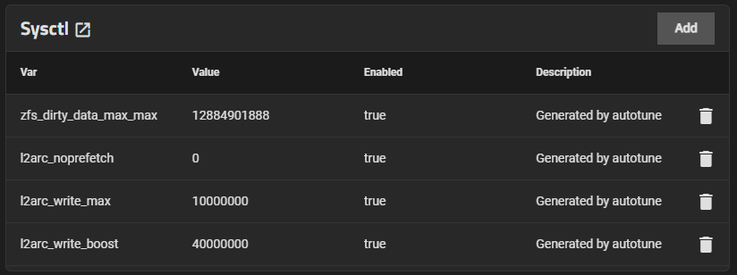

bcat
Oct 20, 2022
84
12884901888
0
10000000
40000000
Hmm, that's weird. It's very possible there is in fact a way to set this through the GUI that I just missed, but I couldn't find one.
HoneyBadger
actually does care
Administrator
Feb 6, 2014
5,112
If this is already noted, apologies:
  • FreeBSD 14.0-RELEASE has 2.2 with block cloning disabled by default.
Beyond that: no other observation from me. <https://old.reddit.com/r/freebsd/comments/182pgki/-/> is pinned, with a pinned comment; my discovery of the bug was through BSD Cafe.
Even if already noted, it's work restating - FreeBSD 14.0 has a sysctl for this vfs.zfs.bclone_enabled that is indeed disabled=0 by default. However, vfs.zfs.dmu_offset_next_sync is still default=1 there.
The method I outlined is the way (and I swear I've done it in that manner on SCALE before, even) but I'll have to repro from a clean slate later so I can send a lightweight debug up to Jira.
