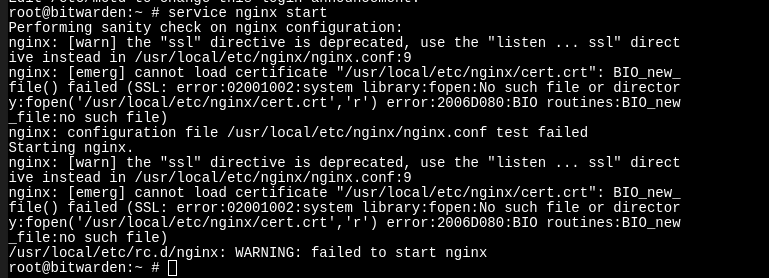

Hey @whokares I am trying to get this installed in a jail as well. What steps did you follow to get proper certificates installed? I keep getting errors that the certificate is invalid :-(. Could it be that duckdns is messing things up?
Herman Eggink
Member
Jan 27, 2014
51
Never mind. My jail exposed the rubywarden port through NAT rather than the nginx port. Silly me :-(.
