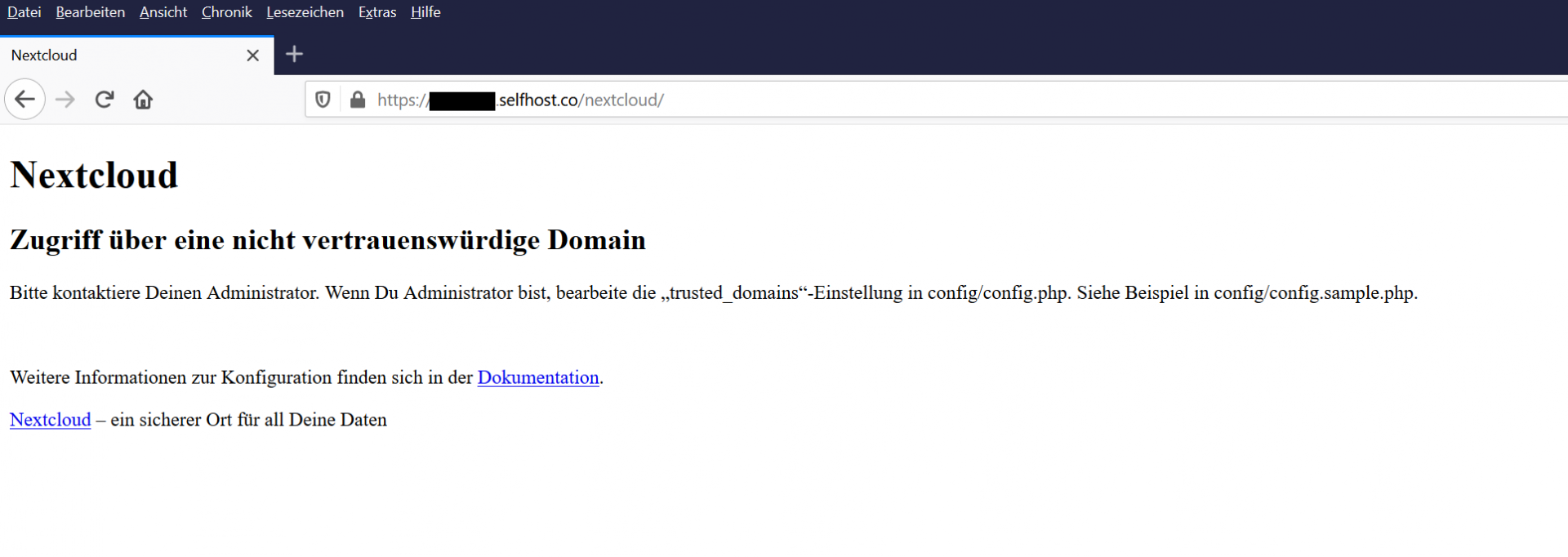

But there is a problem for me using nextcloud with this reverse proxy.
Here the status for now:
When I visit:
my-sub.selfhost.co/nextcloud
("my-sub" is not the real subdomain but I think I shouldn't write the real one here ;-) )
I get to my nextcloud jail and it seems to be encrypted.
The URL now says:
But nextcloud itself has a "truted-domain-check" and in the browser I have to read then:
"Please contact your administrator. If you are an administrator, edit the "trusted_domains" setting in config / config.php. See example in config / config.sample.php."
Looking into the config.php I tried ALL I can imagine (for sure most of it has to be deleted after successful installation).
Have a look here please:
<?php
$CONFIG = array (
  'instanceid' => 'thisIsTheID',
  'passwordsalt' => 'hereIsTheSalt',
  'secret' => 'hereIsASecret',
  'trusted_domains' =>
  array (
    0 => 'my-sub.selfhost.co:8080',
    1 => '192.168.2.205',
    2 => 'localhost',
    3 => 'my-sub.selfhost.co/nextcloud',
    4 => 'my-sub.selfhost.co:80/nextcloud',
    5 => 'my-sub.selfhost.co:443/nextcloud',
    6 => 'my-sub.selfhost.co:80',
    7 => 'my-sub.selfhost.co:443',
    8 => '192.168.2.205:80',
    9 => '192.168.2.205:443',
   10 => 'https://my-sub.selfhost.co/nextcloud',
   11 => 'https://my-sub.selfhost.co:80/nextcloud',
   12 => 'https://my-sub.selfhost.co:443/nextcloud',
   13 => '192.168.2.206:80',
   14 => '192.168.2.206:443',
   15 => '192.168.2.206',
  'datadirectory' => '/mnt/data',
  'dbtype' => 'mysql',
  'version' => '20.0.6.1',
  'overwrite.cli.url' => 'http://my-sub.selfhost.co:80',
  'dbname' => 'nextcloud',
  'dbhost' => 'localhost:/tmp/mysql.sock',
  'dbport' => '',
  'dbtableprefix' => 'oc_',
  'mysql.utf8mb4' => true,
  'dbuser' => 'db_admin',
  'dbpassword' => 'mydbPassword',
  'installed' => true,
  'redis' =>
  array (
    'host' => '/var/run/redis/redis.sock',
    'port' => 0,
  'memcache.local' => '\\OC\\Memcache\\APCu',
  'memcache.locking' => '\\OC\\Memcache\\Redis',
  'app_install_overwrite' =>
  array (
    0 => 'occweb',
  'mail_smtpmode' => 'smtp',
  'mail_smtpsecure' => 'ssl',
  'mail_sendmailmode' => 'smtp',
  'mail_from_address' => 'my.name',
  'mail_domain' => 'yyy.org',
  'mail_smtpauth' => 1,
  'mail_smtpauthtype' => 'LOGIN',
  'mail_smtphost' => 'smtp.yyy.org',
  'mail_smtpport' => '465',
  'mail_smtpname' => 'xxx@yyy.org',
  'mail_smtppassword' => 'myPassword',
192.168.2.205 is the nextcloud jail
192.168.2.206 is the reverse-proxy jail
I can't figure out what to add so that nextcloud accepts the domain I come from as trusted.
May someone can help? Would be great!

I noticed something else:
It seems that my nextcloud is accessible so far but something is wrong with the CSS Style.
I get the error message just in a blank page (please have a look at the picture attached).
In Post #200 I found some additions for the config.php so that it looks now like this (CSS problem and "trusted-domain-problem" are still there):

I hope someone can help me out... it is frustrating to try for days :frown:.
