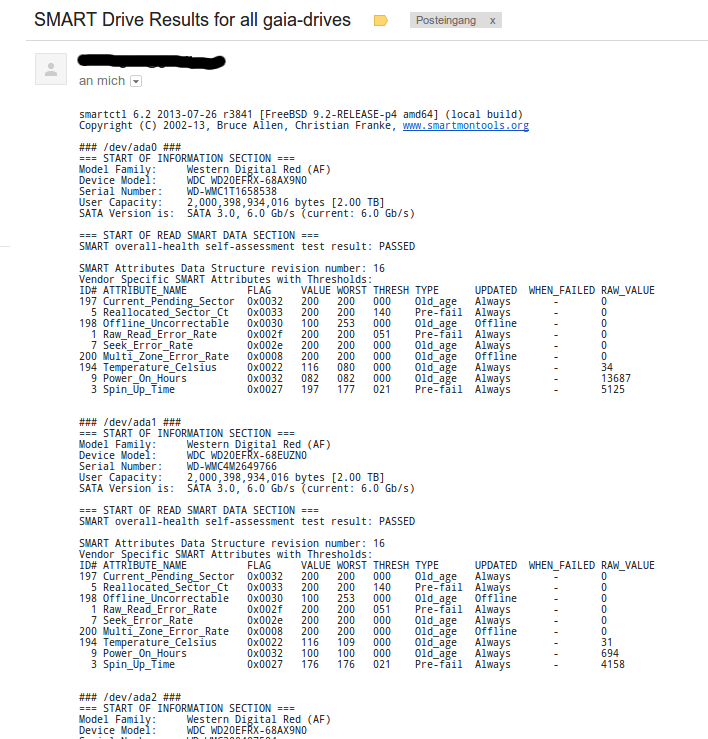

Thanks for the work that already has been done on this matter. I decided to adjust the way the emails are displayed by using monospaced fonts.
This link helped me with that. After playing around with sed ' x,y d' and sed 'x,y! d' I decided to grep everything I want from Smart-Info cause even identical types of HDs can have a different amount of lines been written out by smartctl. The resulting script is rather big, but it should work fine for all sorts of discs.
(If someone with more shell-knowledge than me can point out how to put the echoing for one disc in a single method, that'd be excellent! I don't like violating DRY so much. Might be ok for 4xHD systems, but not on 6+)
So here is my version of the script (for 4 HDs systems)

Btw, I had 3 of my 4 2TB WD-Red RMAed one by one. Thank God I did Raid-Z2. I dunno whats wrong with WD at the moment. Maybe I got a monday-production or I should have ordered HDs from 4 different vendors. So if you wanna buy 4 HDs of a certain type, maybe buy them from different distributors with a month in between.

Maybe I missed it somewhere in thread, but is it possible to add the smart test data to the script?
Im using this one

Jan 9, 2015
430
Im using this one

Something I just happened to notice. Are you checking ada3 twice by accident or do you have an ada4 that is getting messed?
