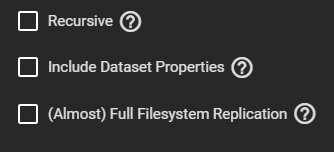

Then try a quick test.
Create a new replication task only for the FLAC dataset, and make sure these three options are unchecked.
Then try to use this task to send to the destination server under a test dataset. (Perhaps something for destination that looks like poolname/test/FLAC)
* Make sure not to try to send/overwrite an existing dataset.
Yes, the destination will be non-encrypted. But you can delete the "test" dataset on the destination if this works. It's only a test.

Excellent idea thanks. This is now running, and ill let you know what happens...

OK completed successfully with no issues!
