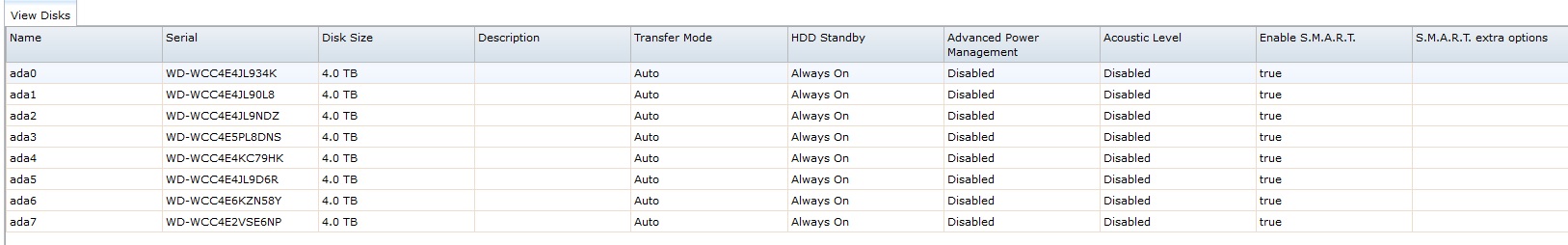

Maybe I have been unlucky but out of the 8 WD red 4tb I bought 3 have shown smart error
CRITICAL: Device: /dev/ada3, 1 Currently unreadable (pending) sectors
not sure how severe it is. but yes I have replaced them with disks from other system. Note the 3 failing were different disks of my 8 disk freenas array. Currently I am all set and I have sent 1 for RMA. 1 is pending the "WD test" and 1 shows no SMART fault in the WD software. I am holding the last one (no smart error) as a hot spare for now. I hope I don't face issues anymore with the current array.
Do you have smart data to show why they failed? Could be poor environment or maintenance.
Bhoot
Mar 28, 2015
241
Would be happy to provide it. How do i obtain the said data? Currently my disks are running at a temp of 35C-40C obtained from the FreeNAS shell. 2 SP 120 fans blowing air straight on the cage. The place I live in is hot and humid yes but there is only so much I can do to control that part. The drives are constantly spinning with activity from various plugins so I would discount disks being idle and then starting all of a sudden causing such issue. I maintain a positive pressure cabinet cleaning the dust filters once in a fortnight and internals once in 30-45 days. So dust imo isn't a factor.
The first SMART error occurred within 3 months of assembly. The last 2 failed in quick succession in December (which happen to be the cooler months) with OAT about 20C average. I do have them in a tower case with 8 3.5" dedicated bay cage (no adapters/ extra fitting than what was provided by the manufacturer).
Infact even I am surprised that I am probably the only one suffering from such problems :(:mad::confused:.
Right now scrubbing my disks for the last 2 hours so I guess I'll call them stressed

HDD temp :
ada7 38C WD-WCC4E2VSE6NP WDC
ada6 37C WD-WCC4E6KZN58Y WDC
ada5 38C WD-WCC4E4JL9D6R WDC
ada4 35C WD-WCC4E4KC79HK WDC
ada3 40C WD-WCC4E5PL8DNS WDC
ada2 38C WD-WCC4E4JL9NDZ WDC
ada1 38C WD-WCC4E4JL90L8 WDC
ada0 36C WD-WCC4E4JL934K WDC
da0

Issue
smartctl -x /dev/ada0
for each device ada0..adaN, then pastebin the result and give us the link.
