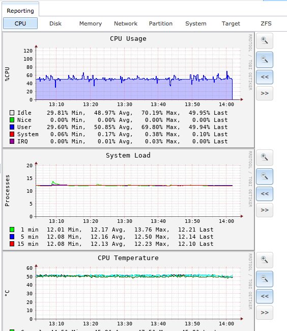

There have been people asking for that to be in the GUI as a bar graph of some sort
15,504
Also for goodness sakes, this should be baked in to the OS as default by now :(
Yes, many people have complained that this isn't in the GUI. Many others have asked in response why it should be. "Synology does it" isn't really an adequate answer to this question--what value does it add to see a graph of disk temps? The design philosophy seems to be, set the alerts where you want them, and the system will alert you if the disks reach those temps.
OTOH, they've added a graph of CPU temps, so maybe they're moving on this issue.
Wait, they have? What version was this added? My test box is on 11.1 iirc and I don’t recall seeing that... can’t login and check at the moment because I turned it off and am not home to turn it on and check lol.
As far as the drive temp issue goes, I am on the “give us an option to turn on a graph” side of the argument. I would be interested to see what temps my drives hit during heavy usage rather then just wait for my smart emails...
15,504
It's in 11.1, old GUI:
Green750one
Mar 16, 2015
36
LIGISTX
Apr 12, 2015
525
Crazy. I have been using 11.1 for a few weeks as I have set up ZFS replication from production box to backup box and I have never noticed that graph... crazy.
Thanks for the wake up call.
