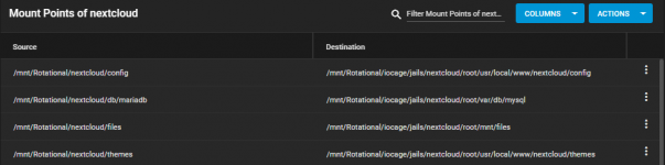

root@nextcloud:/var/db # ls -la | grep mysql drwxr-xr-x 5 mysql mysql 17 Dec 16 20:30 mysql root@nextcloud:/var/db # pwd /var/db
so are you saying the owner of mysql should be www?
victort
Dec 31, 2021
973
The command would be run from the host, not the jail.

Just to be clear, the failing to "Delete old files" is happening within the Nextcloud update gui. Is that still indicative of errors in directory ownership on the TrueNAS host?
victort
Dec 31, 2021
973
It could be because the files are still mounted outside the jail.

root@truenas[/mnt/Rotational/nextcloud]# ls -la total 61 drwxr-xr-x 7 root wheel 7 Dec 17 2021 . drwxr-xr-x 11 root wheel 11 Dec 16 20:10 .. drwxr-xr-x 2 www www 7 Dec 20 2021 config drwxr-xr-x 3 88 88 3 Dec 17 2021 db drwxrwx--- 22 www www 27 Dec 17 07:17 files drwxr-xr-x 4 root wheel 10 Dec 17 2021 freenas-iocage-nextcloud drwxr-xr-x 3 www www 4 Dec 17 2021 themes
victort
Dec 31, 2021
973
This looks correct. Have you checked the nextcloud forums? Perhaps they will have a solution.
