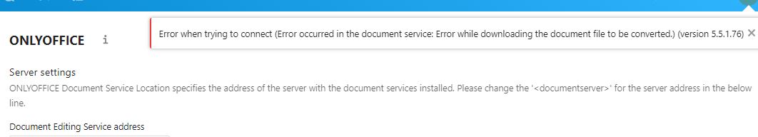

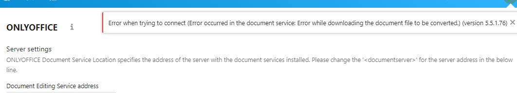

If i disable certificate, the error message like below:
Error when trying to connect (Error occurred in the document service: Error while downloading the document file to be converted.) (version 5.5.1.76)✖
please advice,
Thankyou & regards.
I find this link, it seem the problem similar with me , but i still have no idea how to solve this problem :
Especially this post :
Please advice..
Regards,
victort

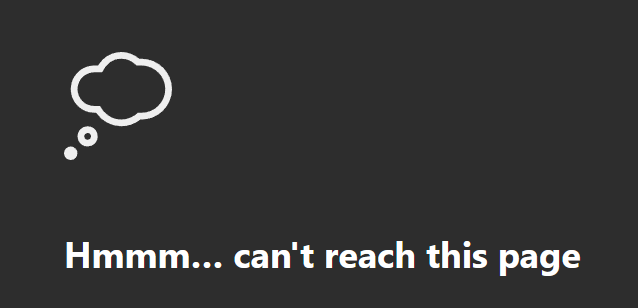

Oh I'm not sure if my images are showing up - the error when I visit the domain is "Hmmm… can't reach this page Check if there is a typo in nextcloud.xxxxxxxxx.com." Not a certificate error, I don't think.
When you ping nextcloud.xxxxxxxxxxx.com, do you get your jail IP?
Not sure what ping means in this context, but if I try to visit it through the browser, nothing shows up, just a "can't reach this page error". Might it have something to do with my ISP's terrible restrictions (no port forwarding to IP addresses, only to connected devices, or DNS settings)?

Open the terminal (cmd prompt) and type ping nextcloud.xxxxxxxxxxxx.com
It should show reply from 192.168.x.x with some data. And the IP address should be your jail IP.
Ah so that looks like the issue, the ping says that it could not find the host. What do I have to change to get the domain name connected to the IP? I've changed the hosts file on my client computer and such.
Correction, now it does show! I had the subnet in the hosts file, so I had formatted it wrong. I also found out that the jail IP will show on my ISP settings if I change the jail to use DHCP autoconfigure (not sure if that will change anything/be needed). Now it's just a certification issue: NET::ERR_CERT_AUTHORITY_INVALID.

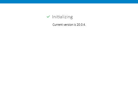

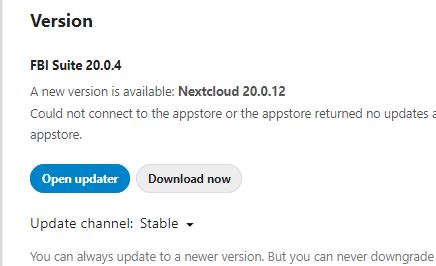

Hi, how to update my nc server in jail freenas : Version: FreeNAS-11.3-U1
currently my nc server version is 20.0.4.
i try to klik open updater :
but the process stuck on
Initializing...​
please advice ,
Thankyou.

victort
Dec 31, 2021
973

victort
Dec 31, 2021
973
Initializing...​
please advice ,
Thankyou.
You are using a very old version of TrueNAS (FreeNAS) at this point. I would suggest first updating that. Then you will probably have to upgrade your jail (instruction are found elsewhere on this forum) and then update nextcloud. Nextcloud latest version is 27 right now.

Regards,
