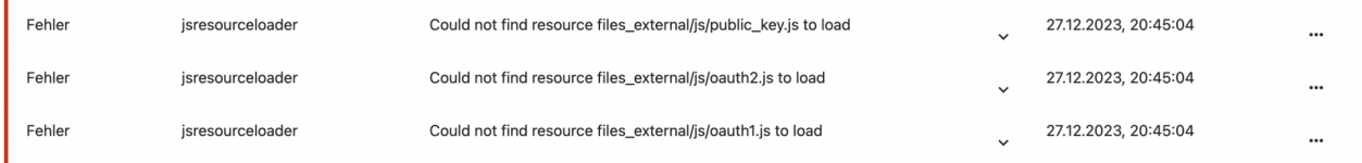

But I run into a small issue, I figured out the following Error-Messages within the Log of nextcloud:
How can I get rid of this?
Thanks for your support.
I have a 'Host override' and 'DNS resolver' enabled on my pfSense router to get rid of that problem. I just followed the installation step by step with the DNS_PLUGIN='cloudflare' option, and after a successful install, I disabled the forwarded ports 80 and 443 to the Nextcloud LAN IP, and it works like a charm.
I renamed the old nextcloud logfile so it is forced to create a new one. Since then no new entry has been created.
15,504
If you're getting the cert using DNS validation, you shouldn't have needed the forwarded ports. But regardless, good that it's working.
