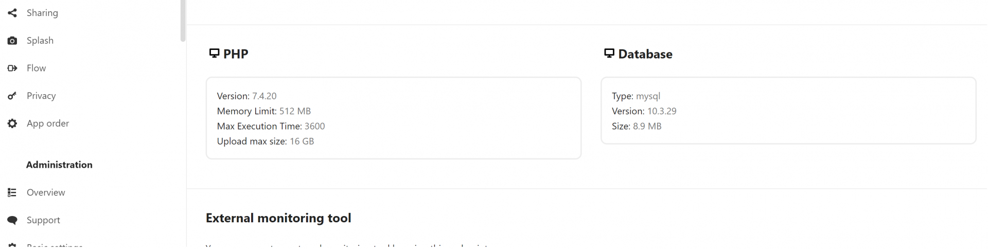

  6. Within nextcloud settings, PHP also tell me that upload size is limited like the picture below. What can I do to increase the upload size limit?
Do you intend to upload files larger than 16 GB? Even if so, I don't expect this to be a problem because of the way Nextcloud handles files.
I do planning on upload files that are larger than 16 and they are 1 big single file. I will try and see how it goes.
