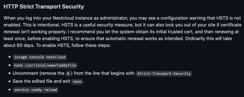

The "Strict-Transport-Security" HTTP header is not set to at least "15552000" seconds.
This is addressed in the README:
BestRaider
May 8, 2021
10
My bad ...i wasn't paying attention ...now the error is gone.
