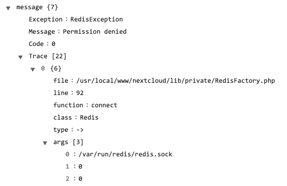

So I'm looking a little further into the Redis issue, and it's a little bit of a head-scratcher. I'd merged a PR a few days ago that told Nextcloud to use Redis. That caused problems with the install script because those commands happened a little too early, so I reverted it, and now installation completes successfully again.
But it should work--after all, Redis is installed and running in the jail; it should be doing something useful. So I moved those couple of lines down a little bit in the script, and now installation completes without errors--but Nextcloud itself isn't accessible; it gives an "internal server error". So taking a look at nextcloud.log (and using jsonformatter.org to make its 6000-character lines readable), I see this:
OK, it's a permissions problem on redis.sock. So I check its permissions:
root@nextcloud:/var/run/redis # ll -h
total 1
-rw-r--r--  1 redis  redis     6B Apr 23 07:09 redis.pid
srwxrwx---  1 redis  redis     0B Apr 23 07:09 redis.sock=
Readable only by the redis user and group. What user is php running as?
root@nextcloud:/var/run/redis # ps aux | grep php
root  34424  0.0  0.5 256024  45056  -  SsJ  07:09   0:00.57 php-fpm: master process (/usr/local/etc/php-fpm.conf) (php-fpm)
www   34425  0.0  0.9 269784  78692  -  SJ   07:09   0:01.36 php-fpm: pool www (php-fpm)
www   34426  0.0  0.8 258556  65180  -  SJ   07:09   0:00.17 php-fpm: pool www (php-fpm)
root  37756  0.0  0.0  11512   2840  0  S+J  09:03   0:00.00 grep php
It's running as the www user. Is that user part of the redis group?
root@nextcloud:/var/run/redis # groups www
www redis
Indeed it is. So where's the problem?
Now, I can set permissions on redis.sock to 777, and it works just fine. That's what I'd done in earlier versions of the script, but it really isn't ideal from a security perspective. But it does prove that access to this socket is the problem. But why?
Php-fpm is running as the www user, which is a member of the redis group, so it should have access to the socket. Caddy is running as root (necessary for it to bind to ports 80 and 443). So what else is trying to access that socket?

The fix made it so it was successfully install all the way. Caddy for Letsencrypt works also. Just taken out from the staging phase and all looks good! Yaay!!! I now have two instances in separate VLANs ...one for my wife and her colleagues and one for me.
What I have been reading in trying to figure out on my own..is that Redis does not have very well written documentation yet. Maybe this is the reason for those memcaching errors. I have also noticed that it points to some access denied errors so I was thinking the same, maybe permission issues....
