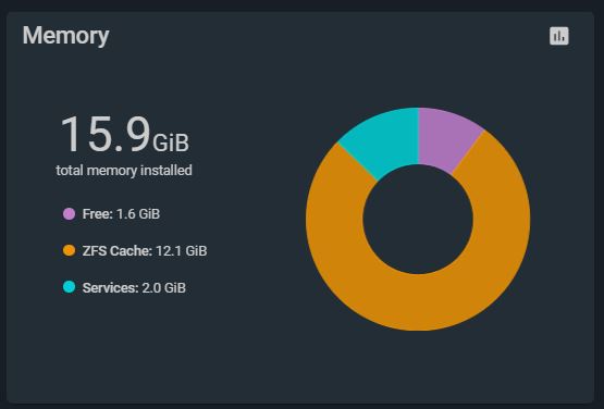

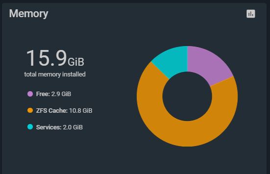

Hi mr.Danb35 and all,
so sorry to bringing up the old post, my nextcloud sometimes is unable to access , it said "502 Bad Gateway",
when i check to freenas dashboard at that moment, i saw that memory free only 0.2 GB left ( for only 2-3 days freenas uptime ) i dunno , is it related to my freenas ram memory ?
this time , when it happening, i've to restart the freenas machine, and the nextcloud back to normal again , it always happening again after 2-3 days uptime.
i just restarted the freenas machine this morning, and after 8 hours later, now the ram free only 1.2GB left .
usually if the free ram only 0.2 GB left , my nextcloud will be unable to access it will said "502 Bad Gateway" again.
please advice , how to solve this problem .
Thank you very much.

InGenetic
Dec 18, 2013
183

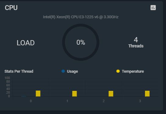

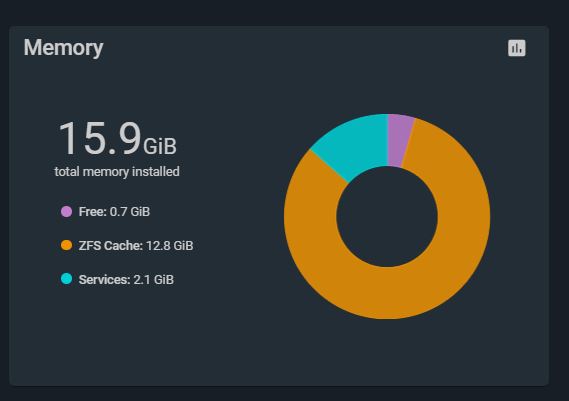

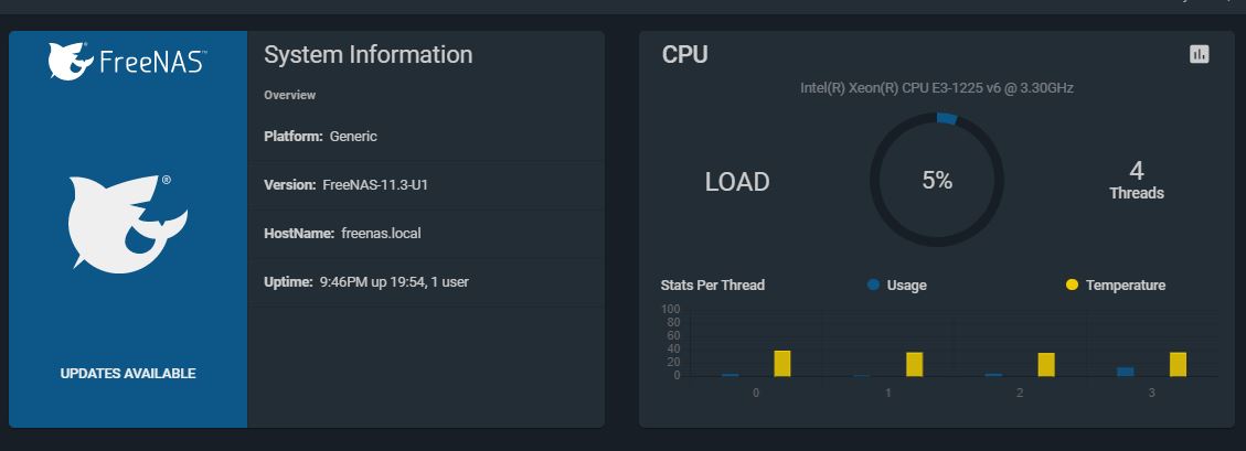

Hi mr. Patrik ,
about my freenas machine , 4 hours ago , the free mem still 9.0 GB ,
now is about 0.8 GB , i'm pretty sure if it's going to 0.2 GB , my nextcloud will be cannot be accessed.
here the process :

Patrick M. Hausen
Nov 25, 2013
7,776
Hmm ... looks like a perfectly healthy system to me. Lots of inactive and free memory, no swap. What precisely do you mean by "Nextcloud cannot be accessed"? Is there a specific error message?
Anyway you should probably start a ne thread. This one is about the scripted installation, not general performance problems. Could a mod be so kind, please?

if i watch carefully , everytime the free mem only 0.2 GB left , my nextcloud url can not be accessible , in the browser just white blank and the notice is "502 Bad Gateway" .if there's no a notice "502 Bad Gateway" , the browser just blank , my nextcloud will be back to normal after i restart the freenas machine , sometimes i just restart nextcloud app from jail , and it's back to normal, but sometimes it's doesn't work , i have to restart the freenas machine , after that my nextcloud url back to normal, everyone can access it.
is it i have to add more memory ram ?

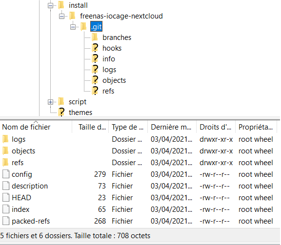

I am stuck right at the beginig of the installation. I can't run the "script nextcloud.log ./nextcloud-jail.sh" command cause there is no such file or directory. See the attachment of the screenshot from filezilla to see the files, as I don't know if there are all here as expected or if there is an issue with the github cloning?
Thanks a lot in advance.

Patrick M. Hausen
Nov 25, 2013
7,776
You need to use ssh to login to your FreeNAS and use the console. What precisely is the command you entered? Please copy and paste the command and the resulting error message. Filezilla is completely useless here.
G8One2
Jan 2, 2017
248
Use PuTTy not FileZilla
Linge
Feb 27, 2021
14
Thanks for your answer.
I am sorry I didn't explain it very well.
I SSH into my NAS and cd to my dataset where I want to install my nextcloud jail. Then I typed "git clone https://github.com/danb35/freenas-iocage-nextcloud" and got the folowing files and folder (as you can see with Filezilla) but the script (nextcloud-jail.sh) was missing. Maybe I am doing something wrong?
G8One2
Jan 2, 2017
248
If you open the README file, it tells you that you need to create a nextcloud-config file. That file has to be created first, before you run the script
