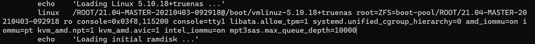

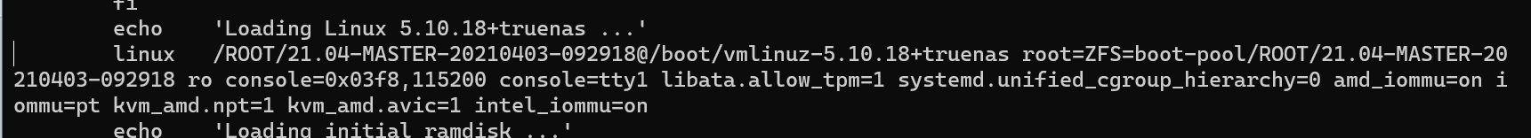

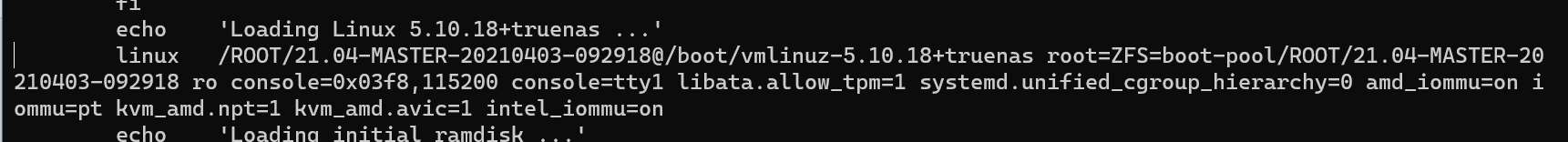

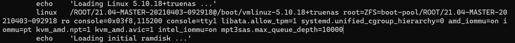

In our case you'd edit by hand /boot/grub/grub.cfg and look for the first boot-entry which looks like this:
Modify it to look like this:
Save and reboot, then see if device shows up.
I use WinSCp to edit that file and save but that code disappeared after restart. I was able to import the test pool i had made but when the system restarted the pool was no longer connected.
How can I make that a permanent change?
