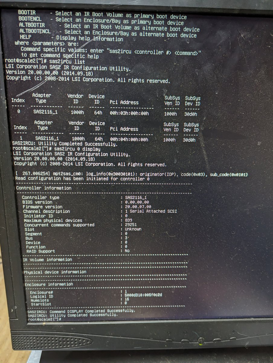

I wanted to provide an update of what I've gotten done in the past 2 days. I did find that the firmware that was installed on the LSI 9201-16e was a later version than I could find on Broadcom's site. So I used sas2flash -o -f filename.bin and flashed 20.00.07.00 IT (P20) without BIOS to them both.

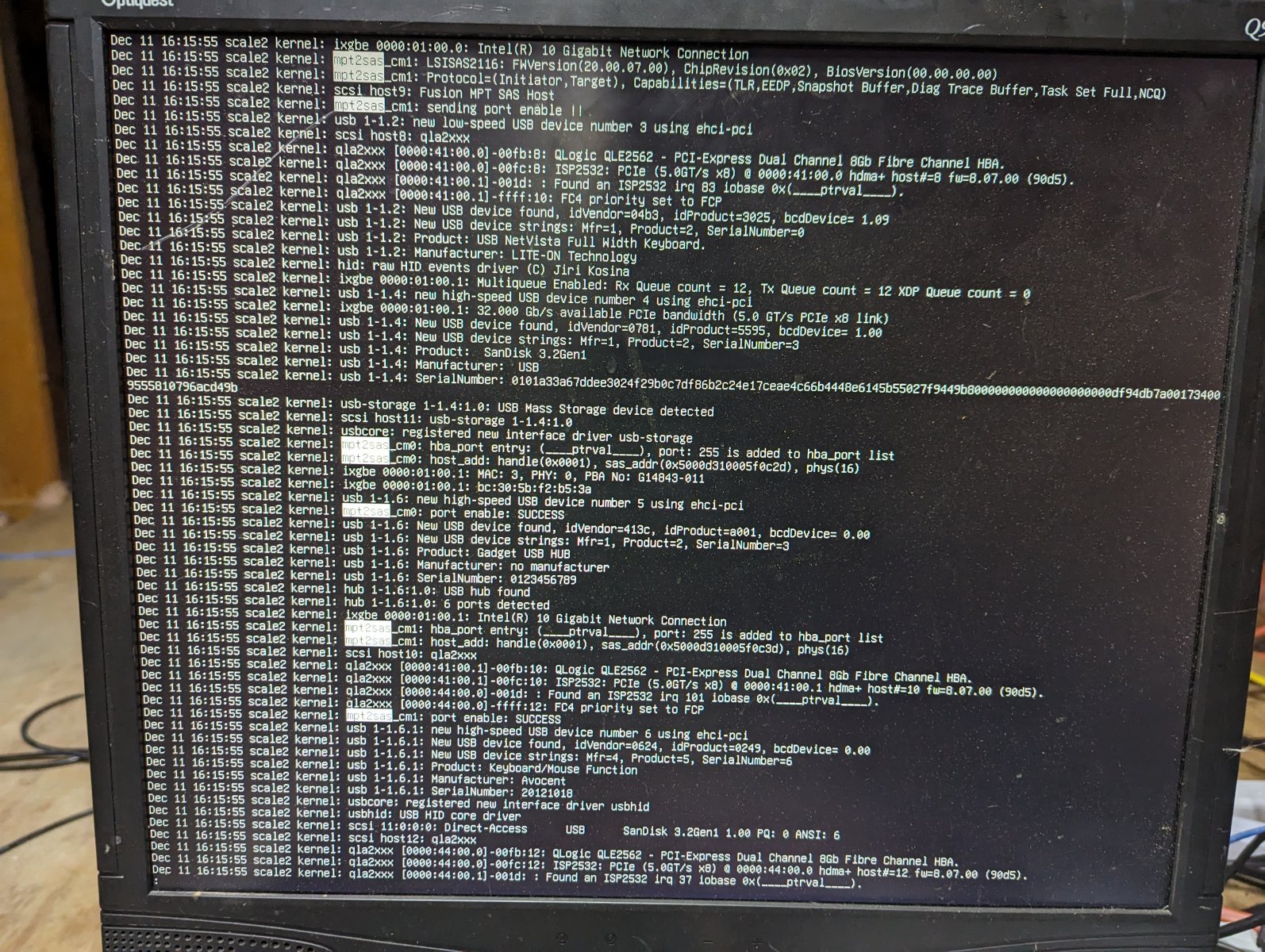

Looking through my syslogs, I can see where the cards are successfully initing (I see mpt3sas_cm0: port enable: SUCCESS and the same for cm1) and I do know for certain that the rootdelay and max_queue_depth options are persisting through reboot. sas2ircu shows my cards, but not my drives, even when directing at a specific card (sas2ircu 0 display).
Also near the end of my original post, there is a typo. lsblk -k should have said lspci -k.
I know the SC200 and SC220 shelves are just rebranded MD1200s, but I'm concerned that there may be specialized firmware on the shelves that limit the host it connects to. Not sure if this is true, but I'm not sure what else to say at this point. I also booted up another OS from USB and received no different results. Is there something that I need to do once the OS is loaded in order to have it scan? Also of note is that the heartbeat LEDs on the back of the shelves are not lit. Only the power lights on the far right. The lights next to each of the 4 ports are dark. It has been too many years since I've messed with storage shelves, but I think those only light up once a connection is established? Should they be lit before or after my OS sees drives?

Also, I have attached a few photos showing the end of my mpt sequence in syslog and what sas2ircu provides.

I solved it. The sas2flash utility that comes with TrueNAS varies from the sas2flsh utility that came with the firmware. I created a FreeDOS boot disk and used the utility there to flash my firmware and everything is golden. I hope this helps someone else!
