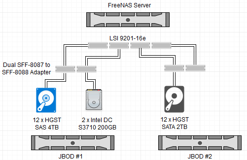

Just a quickly tossed together diagram of what I am trying to accomplish:
Currently trying to use a single SFF-8088 cable for each connection. On JBOD #1, the connection to the SSDs is simply a Mini-SAS Breakout internally. While the actual connections to the drives are a single SFF-8087 to SFF-8087 on the backplane.
Still no love as of yet with just trying to leverage a single LSI 9201-16e...
Oh, you can't do that with SATA drives. SATA is limited to a maximum cable length of 1m and it's rather sensitive.
SAS devices use higher voltage signalling, so you can either swap out the SSDs or add an SAS expander.
