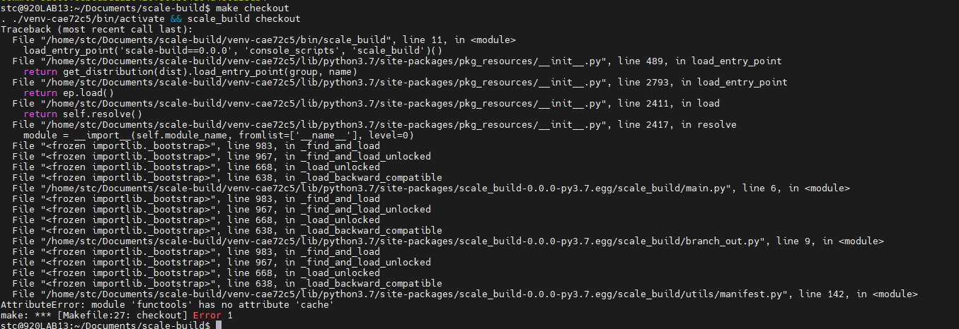

I git clone the scale-build from github and build it with "make checkout".
I got error like this:

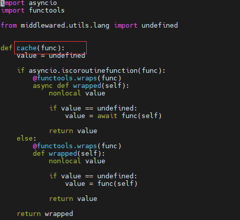

I check the functools.py in middleware, there is cache function.
but I don't know how scale build work. so I don't known the cause of the building problem.

It's referring to Python's functools.cache. You need to use Python 3.9 or newer to run scale-build.
The Makefile uses /usr/bin/python3 by default, which for you is python3.7, hence the error. You can set PYTHON in the environment to be the path to a newer python if you have it. You'll want to rm -rf venv-* to get rid of the python3.7 environment that was set up before you run make checkout again.
