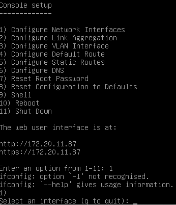

The error that I got:
I was able to setup the IP manually.
Hi all,
I just ran into the same bug and fixed it. Login and edit /etc/netcli.
find the line with ifcongig -l and replace it like this:
pipe = os.popen("/sbin/ifconfig -l")
self._NIClist = pipe.read().strip().split(' ')
with
pipe = os.popen("/bin/ls -1 /sys/class/net")
self._NIClist = pipe.read().strip().split('\n')
All done.
I'll try to create pull request
Best Regards
Makox

Hi all,
with
All done.
Best Regards
Makox
Yep, that works! Thank you.
