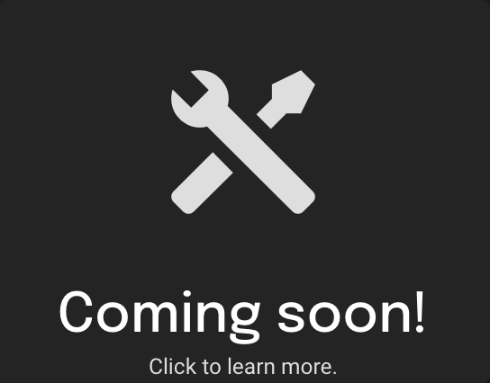

Dedicated Sage
2,898
I'm not sure that our definitions of PREVIEW are the same thing... is this a "preview"?
Kris Moore
VP of Engineering
Administrator
Nov 12, 2015
362
Lol, yea that one slipped though ;) We should get some of that cleaned up in 20.12.
