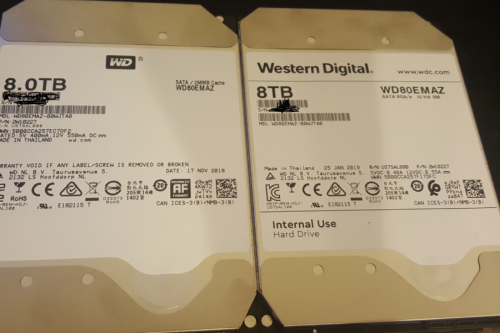

i just finished testing my 6 wd easystores for a 6 by 8TB for a space upgrade.
Nice. I'm curious, what was in those? Are these still HGST He8 rebadged, or something else?
Their HGST He8, but what is weird is the label on one of them.
