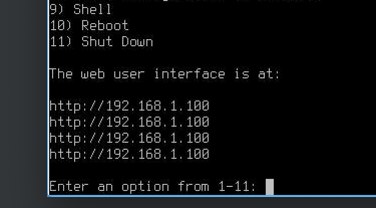

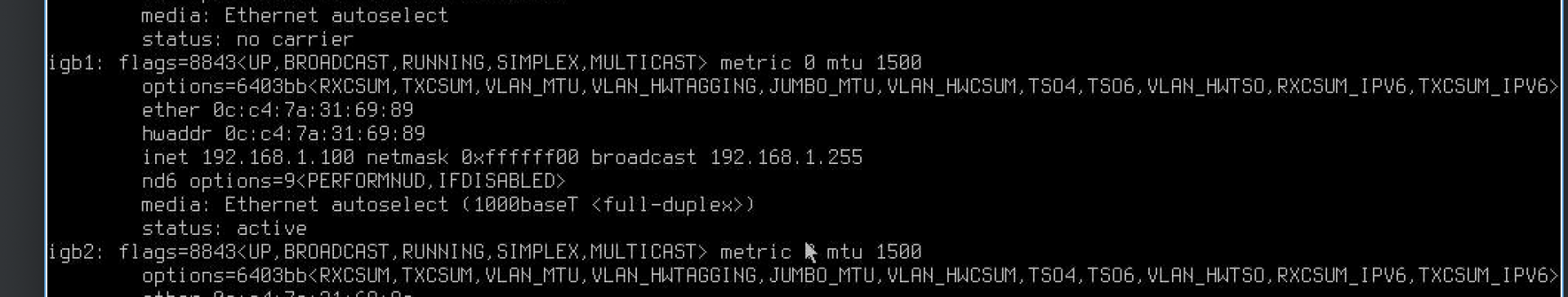

I recently upgraded my FreeNAS system with a SSD boot drive rather than USB stick. Initially, I was able to access the web interface, but now I can't, and I haven't been able to figure out why.
The Freenas system shows in my router at the intended IP. FreeNAS states that the web interface is at the intended IP, and ifconfig confirms that the NIC is working.
What else should I be checking? The connection times out when I try to access web interface. I've tried a few different devices on my network.

You should do some basic connection tests first, to make sure it's not a router/firewall setting.
ping 192.168.1.100
nmap 192.168.1.100
and check on the FreeNAS if the webserver has started.
/etc/local/rc.d/nginx status
/etc/local/rc.d/django status

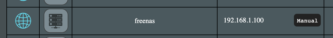

Thanks for the suggestions. I had tried pinging the server and got no response. I had manually set the IP in my router, but noticed that MAC address didn't match ifconfig. I changed it to match, but still no luck. I then deleted that manual assignment so it now shows up in my router as a static IP with the correct MAC address, but no luck.
I will try the other tests when I get home.
I'm able to access a different IP over IPMI without issue.

This looks like a network issue you need to fix.
- Can you ping the router from your FreeNAS Box?
- What is the netmask of the NAS/PC?
- Does the router allow communication between its clients?
Chamrajnagar
Jan 2, 2015
89
No.
I set it to 255.255.255.0 when configuring the static route.
Yes, it was working as recently as a few days ago.
Thanks. My knowledge about configuring networks is pretty limited so I appreciate the help.

You are having a networking issue. As long as you can't ping your NAS, all other tests are irrelevant.
As you are talking about static routes, I assumed all your stuff is in the same network subnet?!
And of course you've tested if it is not the cable?

Yes, all in the same subnet.
Don't believe it's the cable as ifconfig reports it's running at full duplex, and my router sees my freenas system. I'll try a different cable when I get home just to be safe.
Would setting up all 4 LAN ports for the same static IP cause issues? I'm only using one.
Fredda
Jul 9, 2019
608
Why would anyone try to do that??? If you're just using one interface configure only this.
Pretty sure this would be the reason.
Chamrajnagar
Jan 2, 2015
89
So I don't have to remember which of the 4 ports to plug my network cable into.
I'll try deleting the settings for the other 3 when I get home and see if that fixes things.

I'm not sure what type of issues I need to identify. Are there any resources you would suggest? The FreeNAS box shows up in my router with the MAC address of the LAN port I am using. Each port has a different MAC address.
Most of us here seem to take the easy way out and assign an IP to a specific MAC in our router tables - then we don't have to do anything at the client location to maintain a static IP.
This was my approach for the last four years. After upgrading my FreeNAS box last week, it no longer worked. I've since removed the manual assignment in my router.
