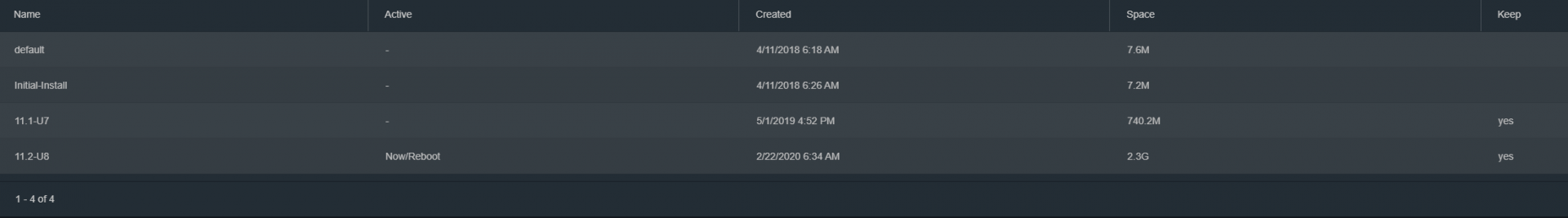

I have choosen to save my 11.1U7 Environment, but i have promoted the datasets.
i though you couldnt go back or you get stuck in read only mode on datasets.
i back up my config all the time BTW.

That's fine. All we want to establish is that U7 behaves as you expect. For future noting: Wait a while before upgrading ZFS flags in case you need to rollback and stay on a previous FreeNAS version until you've resolved any issues.

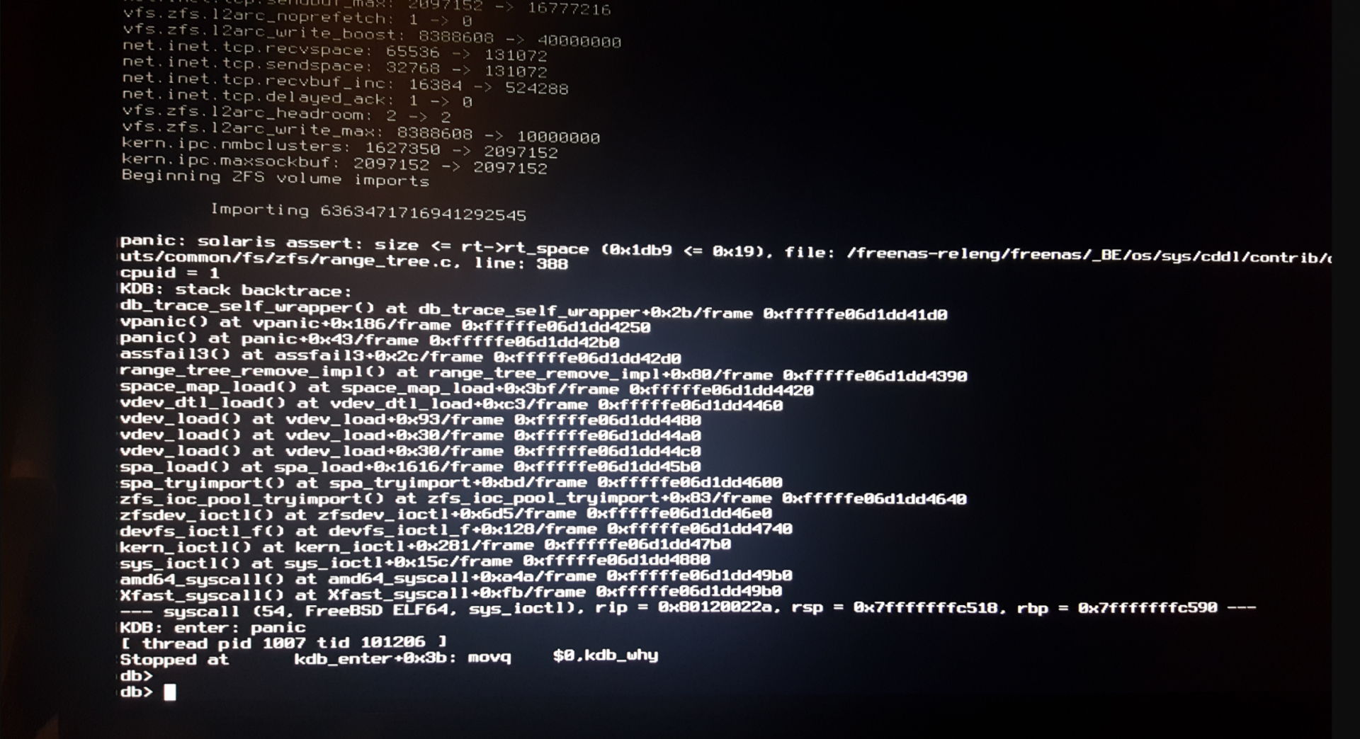

im trying to activate the 11.1U7 env. to see if i get the same issues.

After i activate 11.1U7 it boots to this point.
i still get a ping from it tho....

Freenas is in panic mode (it crashed) from what I can tell.
This is the reason why your system is unresponsive.
You won't go any further in that state.

i was able to get it to boot to 11.1U7 but i still have to go set the ip to get to the gui.

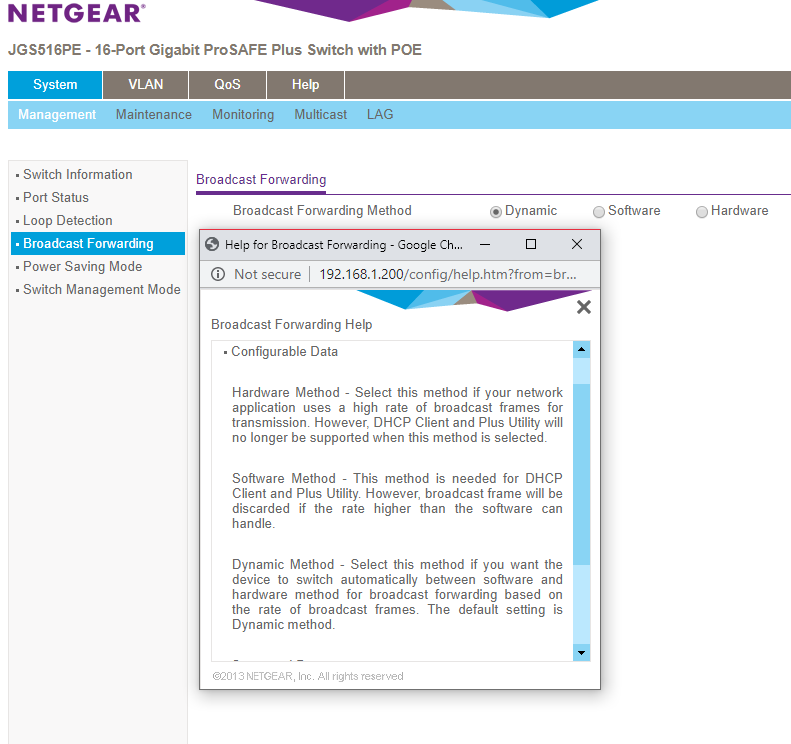

DHCP should be handled by the gateway.
Here is an option on my switch.

I suspect the issue could be related to your switch.
Can you assign an IP address from the switch which will set the IP on Freenas when DHCP negotiation takes place.
