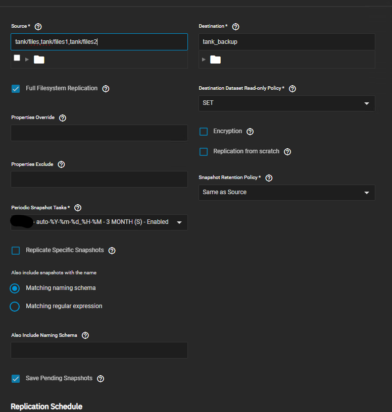

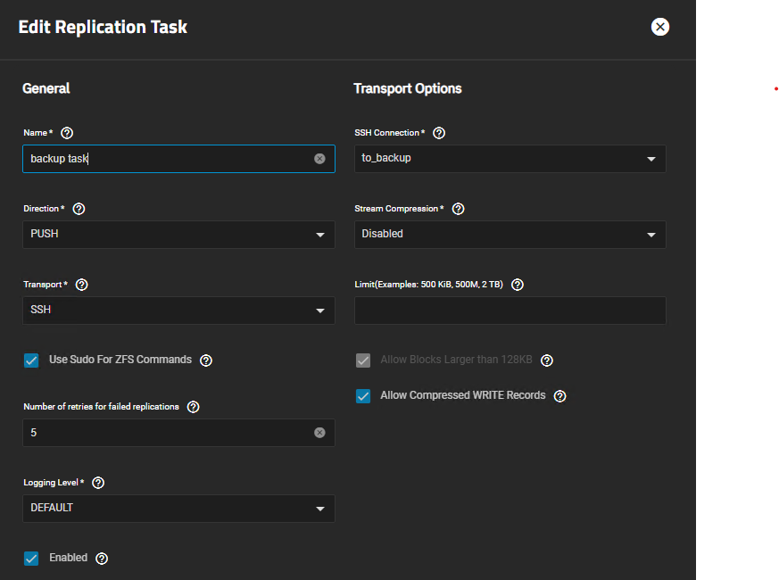

  6. Set up you replication task via TNAS GUI
    • important: set up ANY replication task (even not working) and only then go end edit it. Using wizard it will AutoStart after edition! After saving, run it manually first and click on 'pending' to see if all is good in background.
    • as on picture
    • important: if you have only one dataset you configure SOURCE dataset explicitly and TARGET dataset explicitly; but if you have multiple datasets you configure SOURCE datasets explicitly (as on picture) and root pool as a target!
  7. Verify & enjoy
