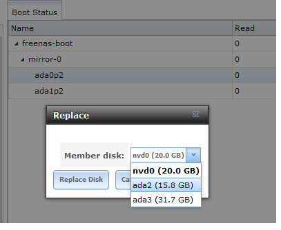

This is what my server looks like after replacement proccess:
Just for testing purpose, I selected "ada0p2", and clicked another time on "Replace Disk". As you can see, I only have a choice of disks which are not used right now:

... and the system is booting again! Right now I'm in FreeNAS and I just took the screenshot you can see at the beginning of my posting. Well, I have absolutely no idea, how this can happen? As you can see, FreeNAS marks both sata-dom chips as being "unused" and "available for disk replacement", but when they are not installed in my server, I'm not able to boot.

So in case anyone of you has some advise or any tipps, I would really appreciate it! I would like to remove sata-dom chips and boot the server with intel ssds. The problem at this point is, that the intel ssds are already in use, as you can see at the screenshot at the beginning of my posting.
