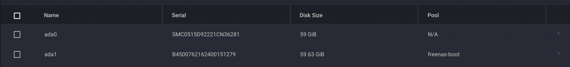

I originally had a pair of SATA-DOM SSDs purchased from SuperMicro as my mirrored boot pool. After years one of the SATA-DOMs finally broke and I ordered a replacement. Unfortunately the older boot disks were labeled (Gen 1) and the new DOMs were Gen 2 -- meaning the capacity of the disks were slightly different. Although they were sold and specified as 64Gb, the older DOMs were 59.63 Gb and the new DOM is 59 GB. I went ahead and installed FreeNAS core onto the newer slightly smaller DOM and then just used the configuration file from the old setup.
I'm having problems however getting the boot pool setup correctly. I need to manually boot into the new DOM however the configuration has this:
I want to specifiy ada0 as the sole disk in the freenas-boot pool, wipe ada1 and then setup ada1 as a mirror. The GUI options however aren't letting me replace ada1 with ada0 because it says it's too small, and I don't know how to manually configure the freenas-boot pool to switch members in the pool. Is there a guide on how to do this?

Backup your config, reinstall to ada0 and ada1 simultaneously - the installer will do the right thing - reimport config.

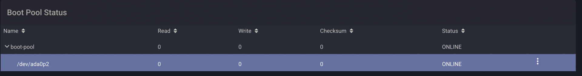

Currently my boot pool looks like the following which I believe is referencing the ada0 disk 2nd partition as when I installed FreeNAS onto the drive I chose the UEFI option:

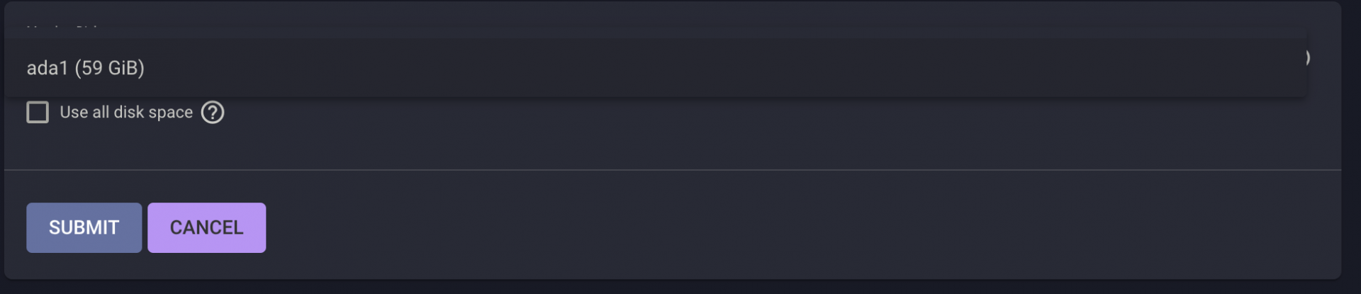

So I'm electing to add the ada1 disk to the boot pool. I choose attach and see the disk as an option:

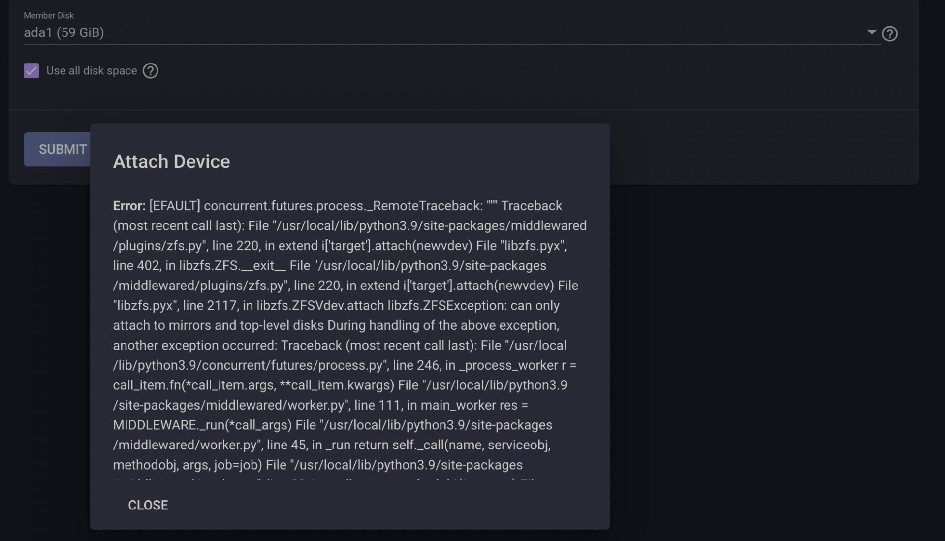

I select ada1 and have unfortunately gone through either selecting to Use all disk space or not use all disk space, but receive the following error:
The error reads as follows:
Error: [EFAULT] concurrent.futures.process._RemoteTraceback: """ Traceback (most recent call last): File "/usr/local/lib/python3.9/site-packages/middlewared/plugins/zfs.py", line 220, in extend i['target'].attach(newvdev) File "libzfs.pyx", line 402, in libzfs.ZFS.__exit__ File "/usr/local/lib/python3.9/site-packages/middlewared/plugins/zfs.py", line 220, in extend i['target'].attach(newvdev) File "libzfs.pyx", line 2117, in libzfs.ZFSVdev.attach libzfs.ZFSException: can only attach to mirrors and top-level disks During handling of the above exception, another exception occurred: Traceback (most recent call last): File "/usr/local/lib/python3.9/concurrent/futures/process.py", line 246, in _process_worker r = call_item.fn(*call_item.args, **call_item.kwargs) File "/usr/local/lib/python3.9/site-packages/middlewared/worker.py", line 111, in main_worker res = MIDDLEWARE._run(*call_args) File "/usr/local/lib/python3.9/site-packages/middlewared/worker.py", line 45, in _run return self._call(name, serviceobj, methodobj, args, job=job) File "/usr/local/lib/python3.9/site-packages/middlewared/worker.py", line 39, in _call return methodobj(*params) File "/usr/local/lib/python3.9/site-packages/middlewared/worker.py", line 39, in _call return methodobj(*params) File "/usr/local/lib/python3.9/site-packages/middlewared/schema.py", line 985, in nf return f(*args, **kwargs) File "/usr/local/lib/python3.9/site-packages/middlewared/plugins/zfs.py", line 223, in extend raise CallError(str(e), e.code) middlewared.service_exception.CallError: [EZFS_BADTARGET] can only attach to mirrors and top-level disks """ The above exception was the direct cause of the following exception: Traceback (most recent call last): File "/usr/local/lib/python3.9/site-packages/middlewared/job.py", line 355, in run await self.future File "/usr/local/lib/python3.9/site-packages/middlewared/job.py", line 386, in __run_body rv = await self.middleware._call_worker(self.method_name, *self.args, job={'id': self.id}) File "/usr/local/lib/python3.9/site-packages/middlewared/main.py", line 1250, in _call_worker return await self.run_in_proc(main_worker, name, args, job) File "/usr/local/lib/python3.9/site-packages/middlewared/main.py", line 1169, in run_in_proc return await self.run_in_executor(self.__procpool, method, *args, **kwargs) File "/usr/local/lib/python3.9/site-packages/middlewared/main.py", line 1152, in run_in_executor return await loop.run_in_executor(pool, functools.partial(method, *args, **kwargs)) middlewared.service_exception.CallError: [EZFS_BADTARGET] can only attach to mirrors and top-level disks
So from what I'm reading in the documentation, this isn't really supposed to happen.

# zpool status boot-pool
  pool: boot-pool
 state: ONLINE
config:
      ada0p2    ONLINE       0     0     0
errors: No known data errors
