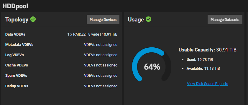

Hey everybody.
So I've finished replacing all the drives in my pool, one by one, from 6TB drives to 12TB drives. My understanding was that once it finishes resilvering the last drive, I should have access to this extra capacity. However, nothing changed.
I also tried manually pressing "expand" and let that run, but that doesn't work either.
I've tried updating to latest version of scale (23.10.2), i've scrubbed the pool. Rebooted a couple of times, but there extra space does not seem to show up.
Anyone have any idea what i'm doing wrong, and how to approach fixing this?..

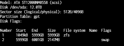

thanks for the reply. I've tried parted /dev/sda resizepart 1 100%
I've also tried parted /dev/sda resizepart 1 12TB
I just get a error with "Can't have overlapping positions"
If I try resizing to 6TB (the old size) It does not produce an error, anything above that, it does (even though the drive capacity is 12TB)
Any ideas?
Dec 2, 2019
30
Ok, with some help on another thread i've been able to figure it out. Had to remove the swap partitions, then i was able to extend. Now it works. hooray!
