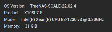

OS Version: TrueNAS-SCALE-22.02.4
Motherboard: Supermicro X10SL7-F
CPU: Intel(R) Xeon(R) CPU E3-1230 v3 @ 3.30GHz
RAM: 4x8GB Crutial DDR3 ECC RAM 1600MHz

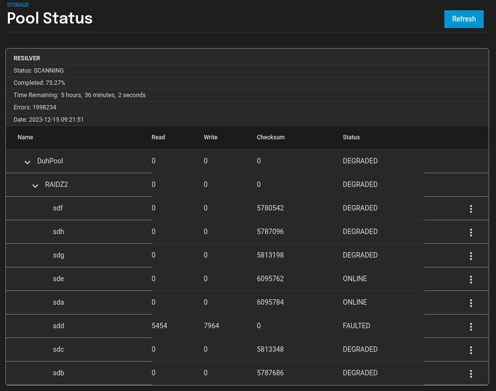

So this morning I had an email notification from my server telling me 2 hdd have faulted. One was practically dead and the other had like 1k write errors. The one thing that confused me was, this happened on 12th december but I had only just got the email so I was a bit unsure what happened there.

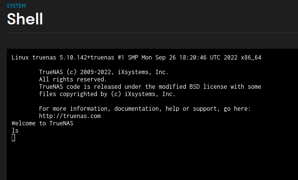

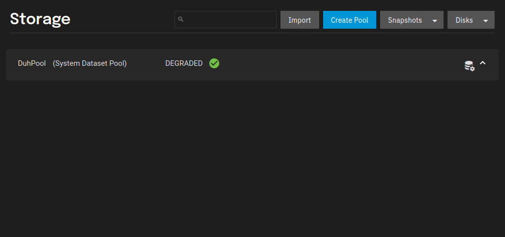

Anyhow, I did the usual procedure of replacing an hdd. The first hdd replacement went completely fine and only took around an hour or so to resilver. I then got around to doing the 2nd one and had to go to work. Once I got home I checked on it and to my surprise, it was still going with an INSANE amount of errors. I've never seen anything remotely as bad! My heart just dropped. My pool was completely gone and I legit don't know where to go from here. I can't even use the shell because it just hangs when first accessing it.
Sadly I'm presuming I've lost all or if not most of the data (roughly 6TB). I'm expecting either there's been a power issue or the HBA likely somehow crapped itself on the 2nd resilver.
The resilvering is still going and all HDD's now show as degraded aside from the 2 replaced ones being online, and another 1 being faulted. (see images)

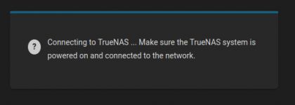

Just a quick update. I've been searching through these forums again to find anything remotely similar since I've posted and during that time. The server web gui is just refusing to connect now. I've not touched, nor attempted anything so it just seems like everything that could possibly go wrong, is doing.
The server is still on and running, no restarts or such. At this point I have no idea what's going on. I can't ssh to it either.
All I'm getting now is "Connecting to TrueNAS ..." etc as shown in the picture.
I've not powered it off in-case some miracle happens (yeah right) and due to it still resilvering. I just didn't want to mess things up even further until I got more information on the matter from more experienced members.
Was planning on powering it off until the poweredge t430 arrives then attempting things with the new hardware.
I'm guessing its safe to assume a power off wouldn't really make anything worse at this point?

I would leave the server powered on. Make sure it has proper ventilation. Even an external house fan might help.
Next, a bit more details;
  • What is the make and model of disks?
  • How are the disks connected? Make & model please.
  • Are their only 8 disks in your RAID-Z2 vDev?
Their are known problems with certain disks, (SMR), LSI HBAs are know to need cooling, (any dust bunnies?), and of course, hardware RAID controllers are really discourage.

Sorry I overlooked the spoiler tag in your first post.
The drives look good. On occasion LSI HBAs can over-heat, causing noticeable errors. I don't remember which type, read, write or checksum. Thus, my suggestion to make sure their is cool air flowing into the server.
I don't have any other suggestions at this point.
