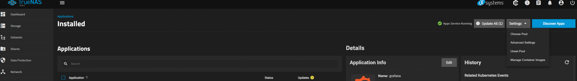

  1. Stop the running application.
  2. Unset the pool in the Settings--->Unset Pool in the app page. This should get the Kubernetes service our of your way
  3. Go through and re-do your networking configuration as you tried to do before
  4. Go back to the apps page and Settings--> Choose Pool and select the pool you had been using.
I think that'll get you passed the place your stuck
