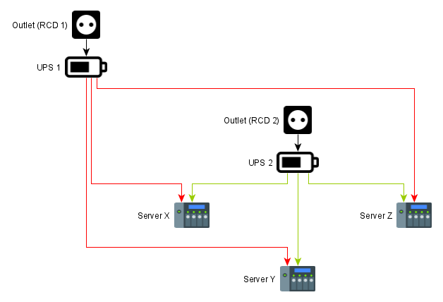

I want to add redundant UPS to my FreeNAS server. Actually the UPS is already there, but of course I also want to shutdown FreeNAS (and other connected servers) when battery is low.
Overview:
There are two UPS, each connected to it's own RCD. The UPS are powering several servers, each with redundant PSU. So maybe server X runs FreeNAS, server Y runs some Linux and server Z runs whatever else.
My idea was adding SNMP cards to both UPS and let all servers query battery state over network. If battery runs low, all servers should shut down. Will this work or am I missing something?
Wizened Sage
4,084
Which battery? if you have low battery on UPS 1 and full battery on UPS 2, do you want your servers shutting down?
You may find you can use USB from each of the UPS units to a server and then use NUT to publish the UPS state to the network from the connected server(s). I use that method with success, but don't connect 2 UPS to the same server.

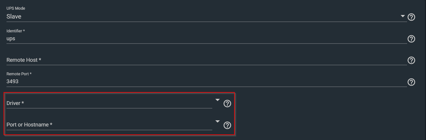

Well, next question: If i chose "Slave" in FreeNAS:
"Remote Host" and "Remot Port" is connection to the NUT master server.
But what about "Driver" and "Port"? My impression was that I should just enter the UPS name on the NUT server?
Wizened Sage
4,084
It's s strange thing... on a server where I have no UPS config, if I enter the config page and select slave, driver disappears.
On another server that has been configured before as master, when changing to slave, the driver option remains.
I'm not exactly sure what to do about that... It seems to work as expected on the new config.
Exhorder
Member
Jul 12, 2019
41
So you just get: Identifier (name of the UPS on the NUT server), Remote Host (NUT Server) and Remote Port? This is what I would have expected, too.
Wizened Sage
4,084
Looks like there was a fix for the "not disappearing driver field" which was delivered in 11.3-U2 yesterday. Perhaps it's a good time to try it out.
