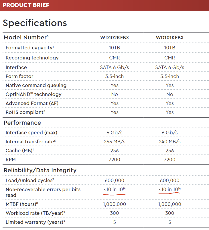

  • RAID-Z1 level of redundancy is no longer recommended, especially with 10 TB drives and doubly so with non-enterprise HDDs (check the WD Red Pro spec and its BER [bit error rate] rating - anything below 1-in-10^15 means a fairly high chance of read errors during re-silvers with such high-capacity hard drives)
    • suggest trying to aim for RAID-Z2

EDIT: attached WD's spec - if you're running RAID-Z1 with these drives (and if the data can't be reconstructed easily), I'd make sure I have a very good backup/restore strategy.
