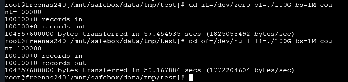

My freenas is build on a DIY box with 64GB RAM, and AVAGO MR9361-8i RAID card (1G cache) with 24 hard drive RAID-6, space is 200TB. No cache drive and log drive. 10Gb Ethernet port.
Free nas version is 11.3-U5. Compression is off. Single volume.
I use dd command to test the read and write speed on it with 100GB file. Speed looks good.
write speed is 1825053492 bytes/sec
read speed is 1772204604 bytes/sec
(check the attachment)
But I use NFS share connect from my test box (with 10Gb Ethernet), CENTOS 7.7 NFS version 3
write speed is 1.08GB/s
read speed is 318MB/s
I don't know why the read speed is slow. Because the RAM is too small? Any one has idea about this?

Start with iperf and test going both directions. Then do a dd test over the wire both directions. See what info that gives you.
9,700
I can see 2 problems here:
This is a bad card to be using. Have you created RAID6 across the 24 disks using the card's RAID? (https://www.truenas.com/community/t...s-and-why-cant-i-use-a-raid-controller.81931/)
Also, if you have correctly allowed FreeNAS to manage the RAID of the 24 disks (and presumably have a RAIDZ2 pool with a single VDEV), that's way wider than recommended for RAIDZ2 (usually 12 maximum).
sorry for the late reply, quite busy.
that is the number I tested on client, the iperf connect speed is 9.86Gb/s.
Thanks for your reply,
Yes, I created RAID6 across 24 disks under the RAID card.
I will try to use JOB mode on that card and try again.
Jbod isn't enough. You need hba
