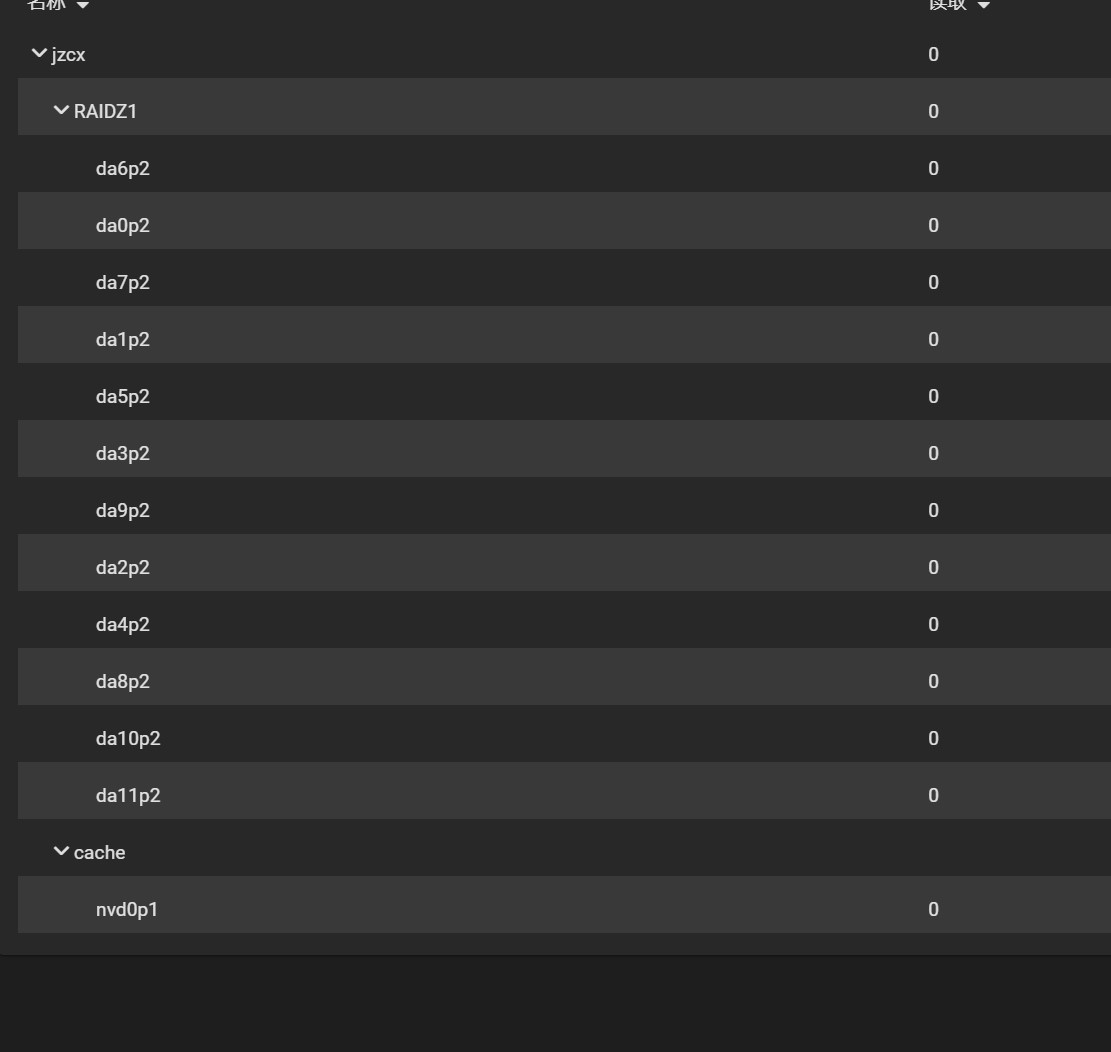

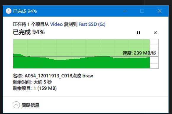

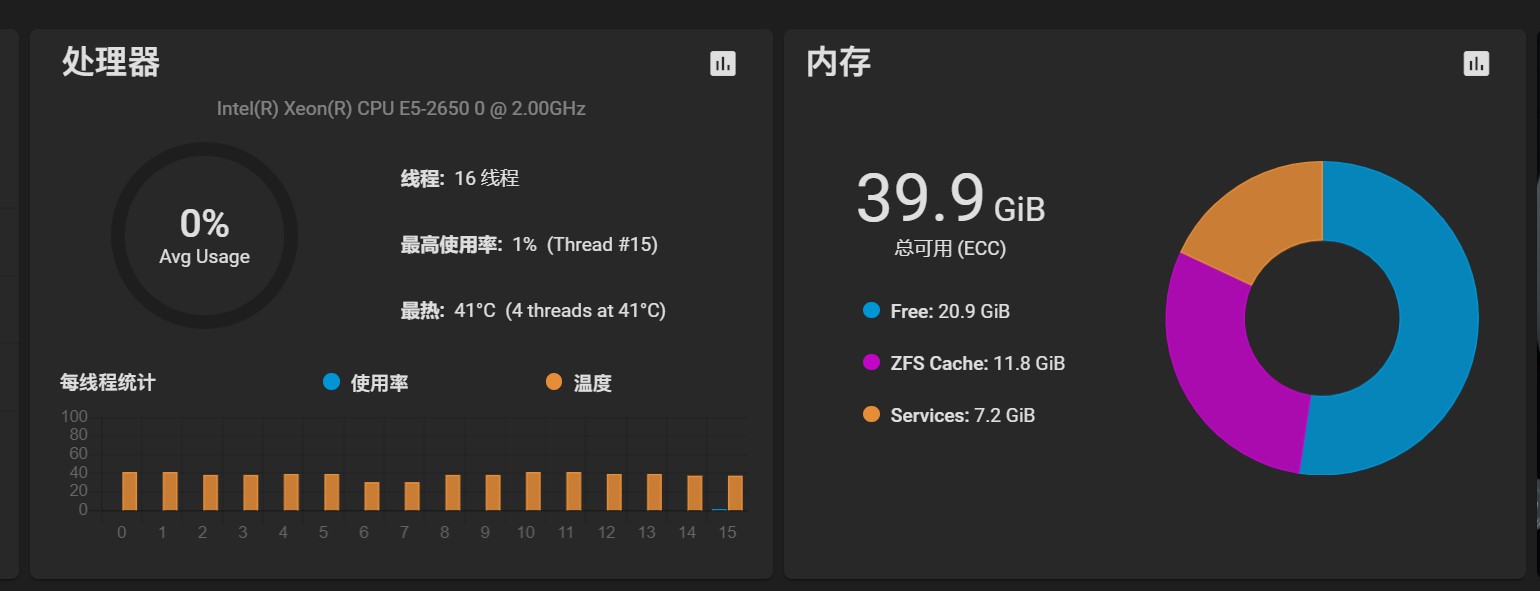

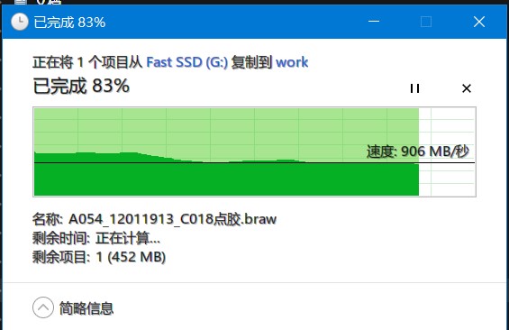

hello,my raid is raidZ(8tX12)cache:sn750 250g
Writing is normal but read is too slow
please help! what happened ?
read only 230m/s(2.6g file)
write(2.6g file)
This speed should only be the speed of the memory

What makes you think that this is "too slow"?
You are only going to get so much speed unless the data happens to already be in ARC/L2ARC.
We recently discussed disk read speeds in the thread here:
and all your answers are probably there. You are simply not likely to get a lot faster than this on a single thread read, given that the underlying disk speeds aren't particularly fast.

Thank you for your reply
But you are wrong
Upgrade to 12.0-U3
Stable reading speed 600M/S
