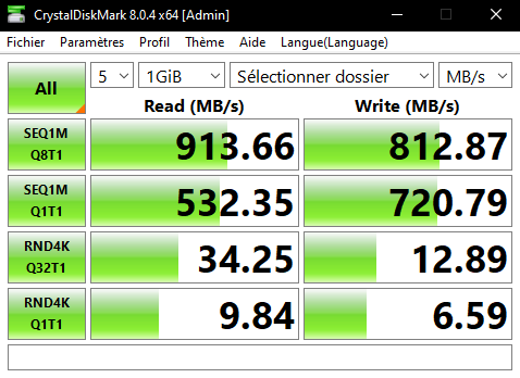

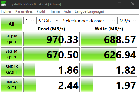

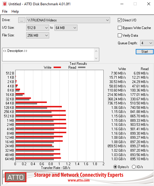

As I can't edit my first post, here are some results I got from Atto and CrystalDisk (1Gb and 64GB) :
