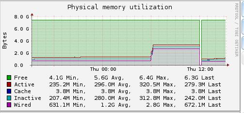

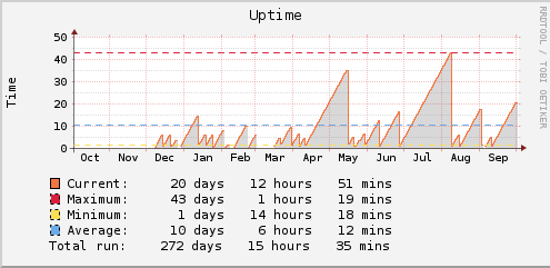

I've included a couple of the reporting graphs to show the behaviour I am seeing. If anyone has any tips/opinions of things to do other things to look at I would appreciate the input.
