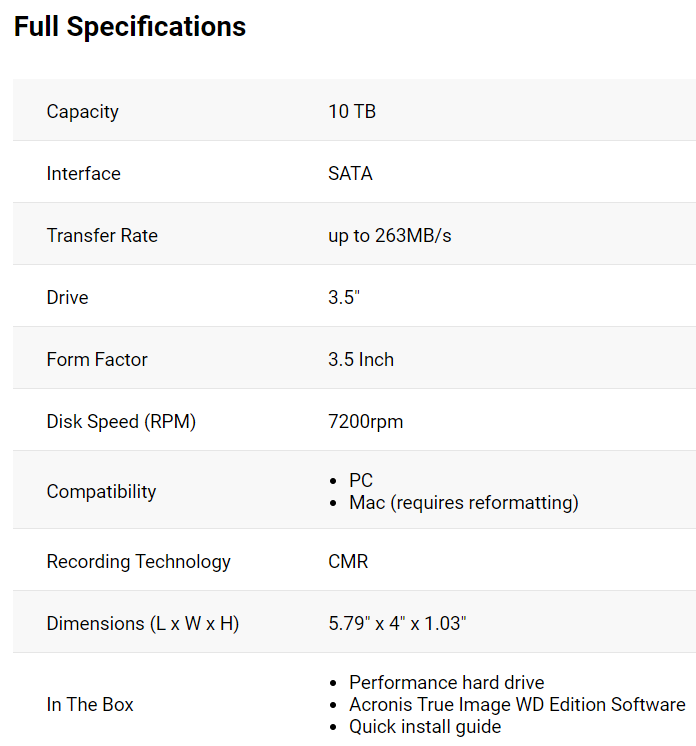

10TB WD blacks for instance are SMR.
Has it changed? Their own store (shop.westerndigital.com) claims that their 10TB Blacks are CMR (as well as every single 3.5" Black drive).
Their PDF (linked from their blog) also makes the same claim as the above.

Has it changed?
I must have done a quick google search and the 2.5" must be SMR. Either way, I suspect that they have reverted many of their drives back to CMR to save face. Hopefully the majority of what I wrote was of use.
