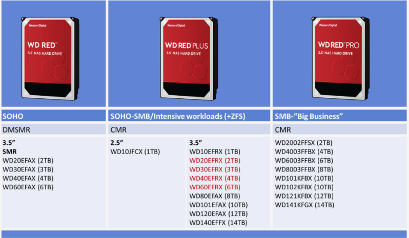

per servethehome and other outlets, WD announced that they’re going to segment their red line into three different families,
  • Red (DMSMR)
  • Red+ (CMR @ 5900 RPM?), and
  • RedPro (CMR @ 7,200 RPM)
I’d wager this is designed to help with the upcoming class-action lawsuit rather than anything rooted in marketing 101. The amount of customer goodwill this decision-by-committee is going to cost in the long run... just wow.
there simply isn’t a reason for the new red line to exist other than to fool people into buying a shingled drive based on past good experiences with Red CMR drives. At least they are now up front about the guts of these drives.
I don’t know. There might be a reason. Some folk count their dollars very closely, and I’d assume that this change goes with a drop in price. Of course it could be the other way around and WD could raise the price of the Plus. We shall see presently - are these drives in the channel yet?
Could also mend some broken fences instead. There is now a clear understanding of which type of drive is where, and what it’s for. “SMB or ZFS, Red+”. Then again, I am maybe a little too far away from the “oh a drive, slap it in” crowd to know how this will actually play out with customers.
That was not the case at the consumer end. On Amazon, the Red SMR drives sold at the same price as the Red CMR drives, the last time I looked. WD may have sold SMR drives into the channel at a lower price, however. Though unlikely, resellers may have been pocketing the difference. Based on the available evidence, the more likely scenario is that WD tried to pull a fast one.
I haven't seen them yet, I presume this blog entry is a bit of a trial balloon to see the market reaction. I would be willing to give WD the benefit of the doubt if they had come up with this drive family technology-split ahead of time. That is, announce the new Red lineup, along with accurate spec sheets for each set of drive families, then ship DMSMR drives to customers who are willing to take the performance hit in return for 20% more capacity. WD did none of that.
I don't agree. The Red line of drives was marketed exclusively for years towards NAS applications and was priced accordingly. The Red series is a strong brand precisely because they performed well in this application. Hence also the strong preference from shuckers of external enclosures for WD drives with Red vs. White labels, even if the mechanism and the firmware is the same.
Rather than re-designating Red as Red+ and cheapening the original Red brand, DMSMR drives should have been kept out of the NAS-drive channel (i.e. the Red family of products) altogether. You can't tell me that Manfred Berger was the only guy at WD who knew that DMSMR had no place in ZFS or other NAS applications. Seagate and Toshiba are likely sending platters of expensive cheeses and wines to the WD Red team conference room as we speak, this was the best thing that happened for them in a long time.

The 8TB and up are available now, since nothing has changed there.
For 2-6TB, they’ll need to start making EFRX again. WD says “WD Red Plus in 2TB, 3TB, 4TB and 6TB capacities will be available soon” at https://blog.westerndigital.com/wd-red-nas-drives/.

Anytime a product family has a inconsistent SKU lineup, all I can say is "watch out". Note how the Plus product family now has a mix of EFRX, EFAX, and EFFX SKUs. Even more confusingly, the regular Red lineup has the same EFAX SKU designation as the higher-capacity Plus drives. To me, this is a pretty disjointed attempt to play cleanup after the fact to deal with the coming class-action lawsuit.
The only saving grace to this lineup is that customers looking to buy EFRX SKUs will be once again able to do so and EFRX drives will remain CMR.
If this had been planned properly, the DMSMR line would have been EFAX, the plus line would have been EFRX throughout. Claiming that DMSMR drives are NAS-compatible (see the sticker on the drive) after explaining to the world why DMSMR drives are unsuited for NAS applications is pretty brazen.
