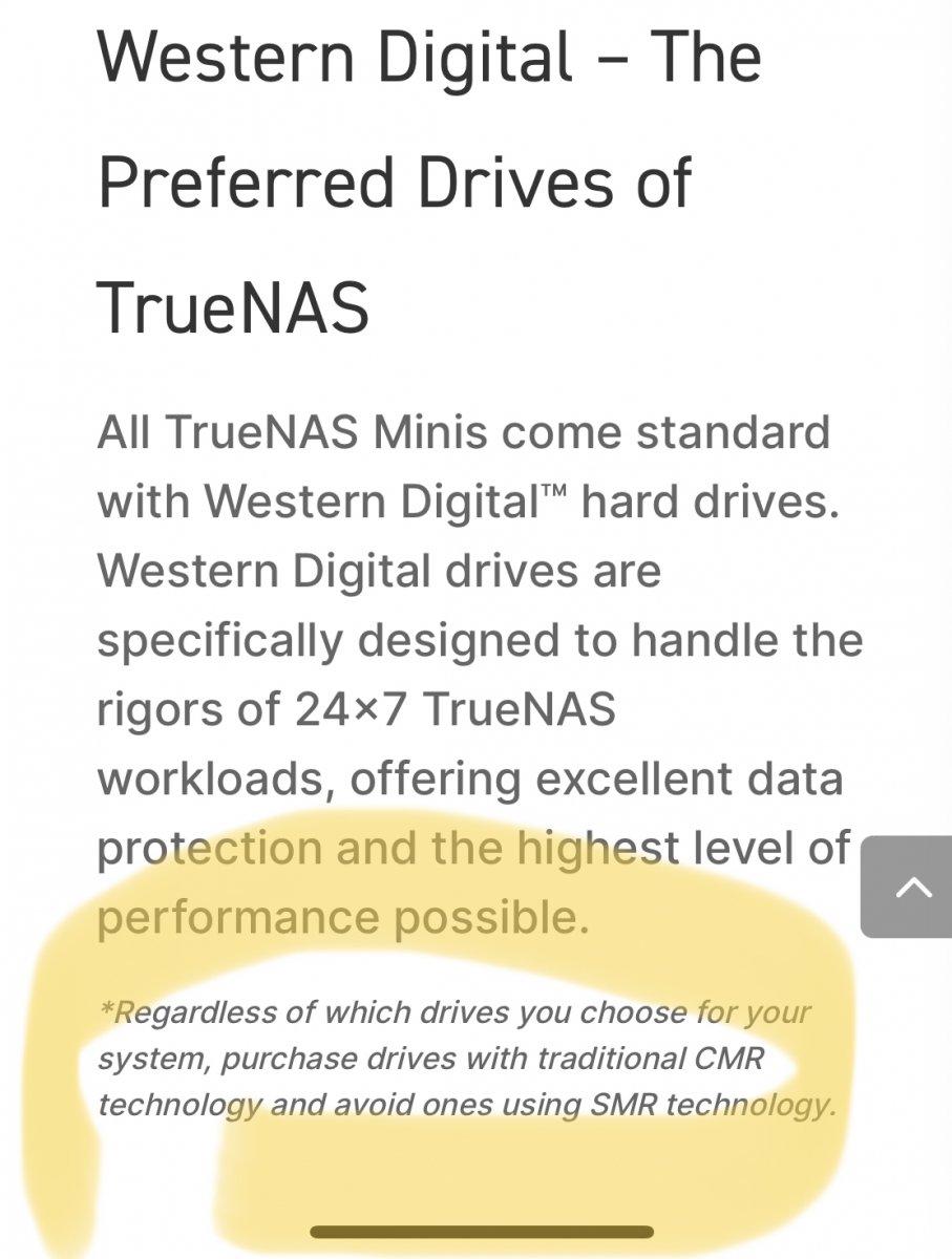

Allow me to politely disagree. The banner advertisement is small enough on my screen to simply show as yellow and red labeled hard drives. Finer distinctions (such as plus and pro designation) are only really visible if I enlarge the ad.
I understand that you have a long-standing B2B relationship with WD and presume that someone came to you hat in hand to ask forgiveness. Perhaps WD is now offering a significant discount to continue to be iXSystems supplier of choice.
But, it’s also important to be a bit more explicit in the landing page that the ad goes to. Mentioning CMR vs. SMR without context with a small asterisk, in smaller type than the rest of the article for products aimed at entry level users isn’t providing the proper level of warning for neophytes.
I suggest updating the ad landing page to include a link to the DMSMR resource page that @Yorick put together. That also helps beginners understand the difference between DMSMR and other SMR drives, CMR, and so on. It further exposes the customers to the great forum horde here.

Yes, my suggestion would be to re-write that section of the mini and mini-Xl page to be more explicit re: DMSMR vs. CMR in FreeNAS, TrueNAS applications. This potential user base is unlikely to be as knowledgeable as the many Demi-gods here (of which i am not one!)
For example, you could note that while WD is the OEM supplier of choice at iXSystems that the following SKUs in WD Red’s line up should be avoided (ie everything EFAX between 2-6TB) Then offer the option to readers to go through @Yoricks’ excellent page for further insights re DMSMR vs. CMR, etc.
Nothing wrong with noting that the list may not be exhaustive, potentially won’t cover shucked drives, etc... but the key thing to convey is just how much hair-pulling may result from using current plain WD Red drives. Nor will it be apparent to folk who bought red drives two years ago that entry-level Reds are no longer endorsed for NAS use at IXSystems. So it’s important to convey that info lest the bad experience sully iXSystems’ good reputation.

Hi Constantin,
the Mini page is designed to help us market Minis to the general public, some of whom are not forum users. We don't use SMR drives in the Minis being sold and so have zero reason to bring up the SMR issue, but we did add a note to make sure the issue was not swept under the rug.
We need a lighter weight process than what you are recommending. The community forum pages are designed for disseminating technical information to TrueNAS CORE software users. A link would be appropriate and not impact the normal Mini customer who is look for an appliance that works and doesn't require detailed technical knowledge of all the components.
Hope you can understand that there are multiple audiences we must address.

Again, allow me to politely disagree.
As long as iXSystems sells diskless Minis (and I was one such -XL customer) there is a good chance that a customer will try to marry DMSMR drives with a FreeNAS since WD continues to market drives into the NAS channel that they (and IXSystems) have identified as unsuitable for use with FreeNAS.
Please consider a more explicit warning on the Mini ad landing page and in particular for the diskless configurations. I understand that WD is likely exerting a lot of pressure on iXSystems, that working within the confines of a 3-way HDD OEM oligopoly is not easy, etc. but I’d also consider the impact on iXSystems for customers not getting warned adequately re: DMSMR.
Other industries do this as well - Trucks and cars have explicit stickers on fuel tank inlets designating the type of fuel that should be loaded (Ie “Diesel ONLY”). OEMs don’t apply these stickers because they’d be liable for a customer not reading the manual, filling the car with the wrong fuel, and having a learning experience. No, they do it because they do not want to associated with said learning experience.
If warning customers on your web pages re DMSMR drives is too controversial, perhaps iXSystems can include a informative flyer in the box with each diskless sale that is more explicit re the pitfalls of DMSMR (and not just at WD)? Perhaps feature a QR code to take diskless customers @Yorick’s resource page? Or a sticker on the chassis?

Appreciate the reply. Below is what I’m getting at:
The warning re SMR features an odd asterisk, is in smaller type, does not provide context, nor a link to more information. I respectfully suggest making the type the same size as the surrounding type and adding a link to further elucidate interested parties.
Lastly, a sticker on the inside or outside of every metal enclosure may be a good reminder to buyers that peak HDD performance is precluded if non-CMR drives are used. That sticker could include a QR code to direct interested buyers to your HDD vend page and/or registration options.
