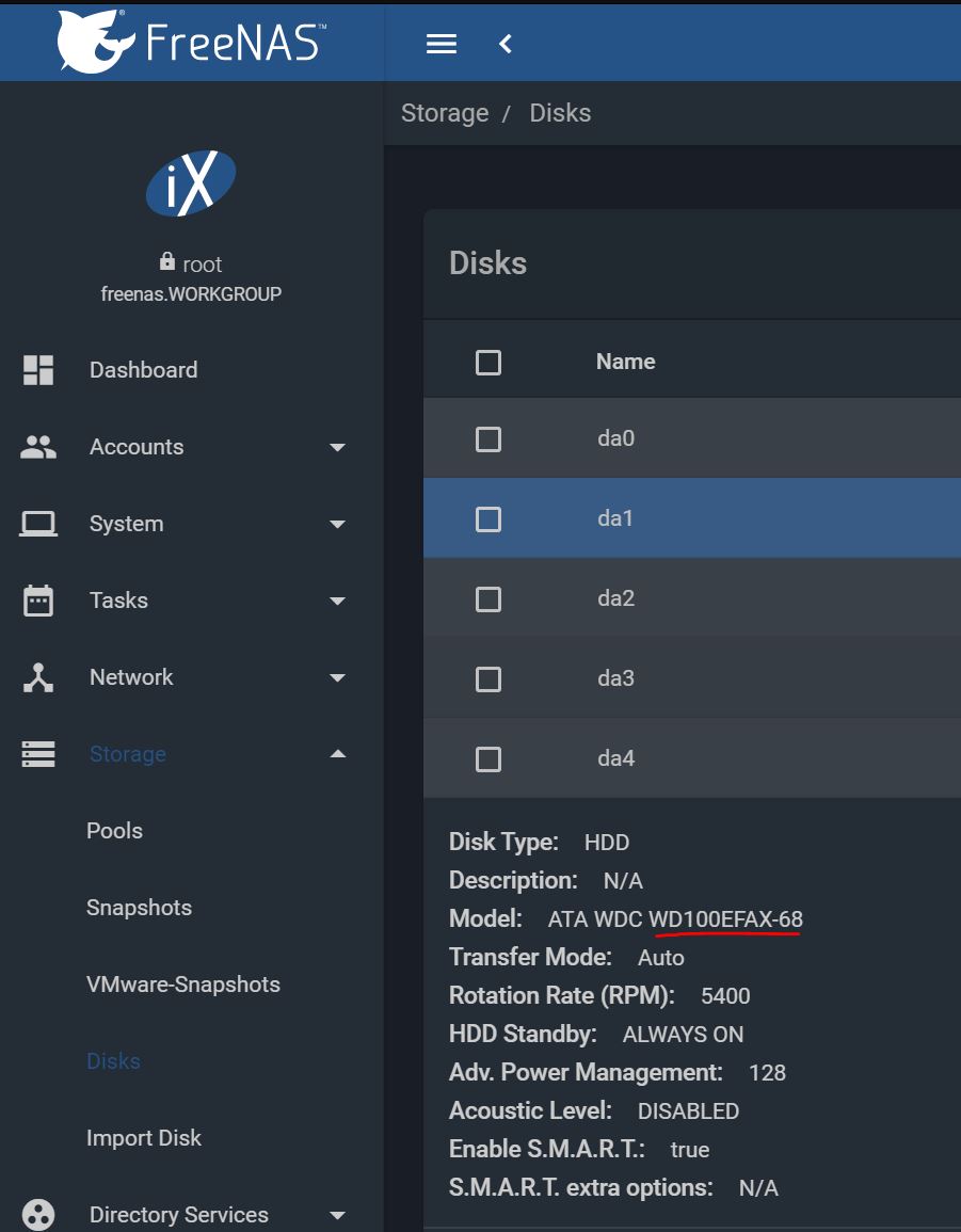

how to check:

According to Western Digital, only the WD Red with 8 TByte to 14 TByte use the classic Perpendicular Magnetic Recording, the models with 2 TByte to 6 TByte however use the slower Shingled Magnetic Recording. A renewed look at the data sheet shows that the smaller HDDs with 64 MByte cache achieve a sequential transfer rate of 147 MByte/s to 150 MByte/s, whereas the larger hard disks with 256 MByte buffer achieve 196 MByte/s to 215 MByte/s. What falls under the table is the significantly lower transfer rate for random access. The slower SMR models are now (pdf) marked as EFAX, whereas the faster PMR drives are marked with EFRX .
Note from my end; it seems the article did a mistake I think the slower ones are actually EFRX, while the faster ones should have EFAX

how to check:
