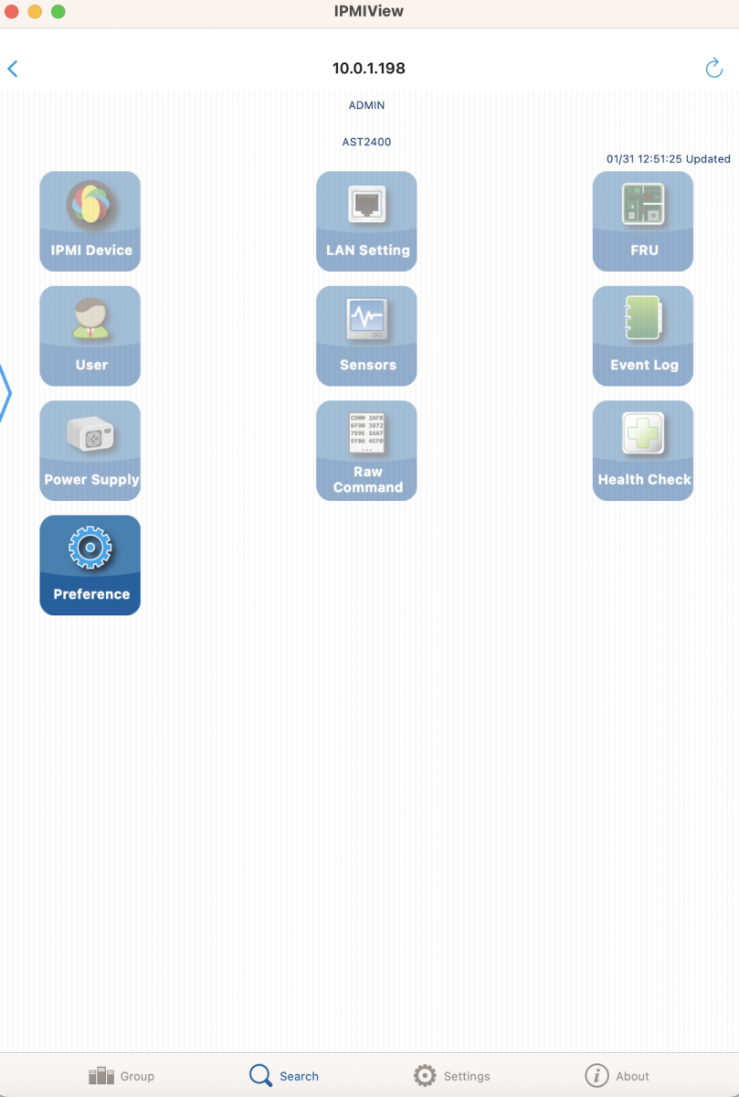

I'm using IPMIview 1.9 on MacOS Monterey and this is all I'm getting. It's like authetication isn't working or something. I'm trying to get to terminal.

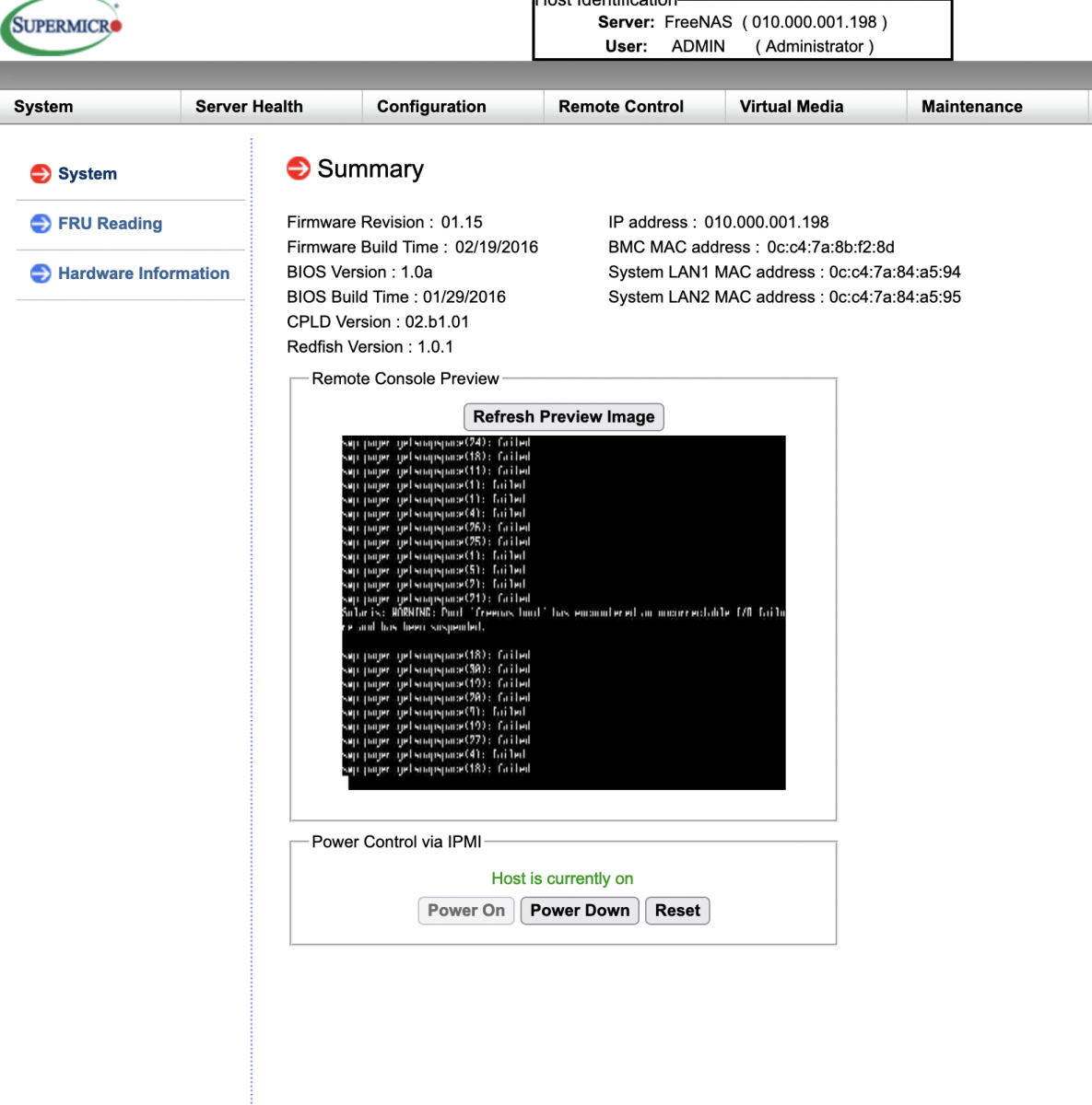

Not sure what you're exactly referring to -- either the ipmiView version or MOBO version -- I used to be able to using the remote console via JVM through the web interface:
There is no "MOBO version". There is a web server on the IPMI controller on the motherboard that is also capable of launching a Java console viewer, but this is not IPMIVIEW.
I am saying use IPMIview. 2.0. This is a package distributed by Supermicro that is actually a Java app. I don't see a remote console option in whatever the Apple "IPMIview" thing is, which is more or less how I remember ancient IPMIview 1 to be like.
