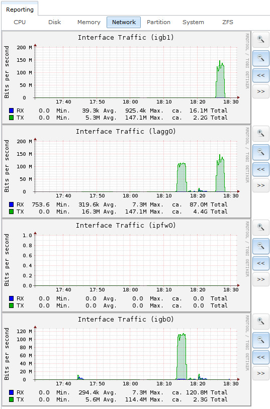

What does "failover" do? It's very simple. You connect two (or more) ethernet connections. One of them (say, igb0) is, as before, your main network connection. 100% of your traffic flows through it. The other one (say, igb1) is connected to your router/switch also. Typically, no traffic at all egresses or ingresses to your FreeNAS box via this link (though, you will still get the general network traffic, such as broadcast packets, or whatever else impinged that ingress). But, in the exceptionally unlikely event that your NIC or cable or port dies on the first link, it will instantly without even a moment's pause simply use the second link, and no one is the wiser. When/if the first link comes back up, it will automatically go to the main, first, link again. Worked pretty well too! I started a download of a 15GB movie, pulled the cable, and it failed over without hardly a blip on the transfer throughput.
I have a picture of this in action. I transferred a 2GB movie with both plugged in, then pulled the first main interface, and did it again. You can see how it fails over:

So now, in the 0.00019% chance that your primary network cable or port goes out, you are now automatically going to use the other one. Pretty sweet, as an exercise, at least. Go ahead and pull the main ethernet cable, and observe the cuspiness of the failover.
