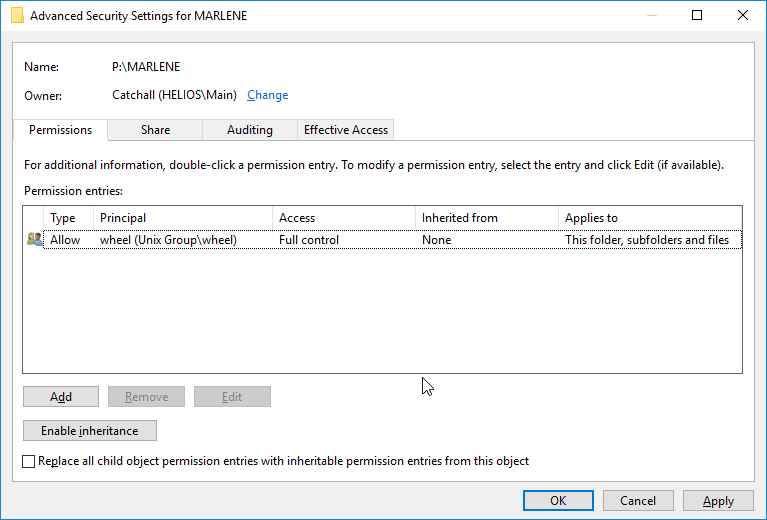

lets say I have a share with guest access allowed, but I only want marlene to be able to access a specific folder(in this case named MARLENE) in that share and nobody else
I would right click that folder I want to change access to and go to properties
then on the security tab I would hit advanced

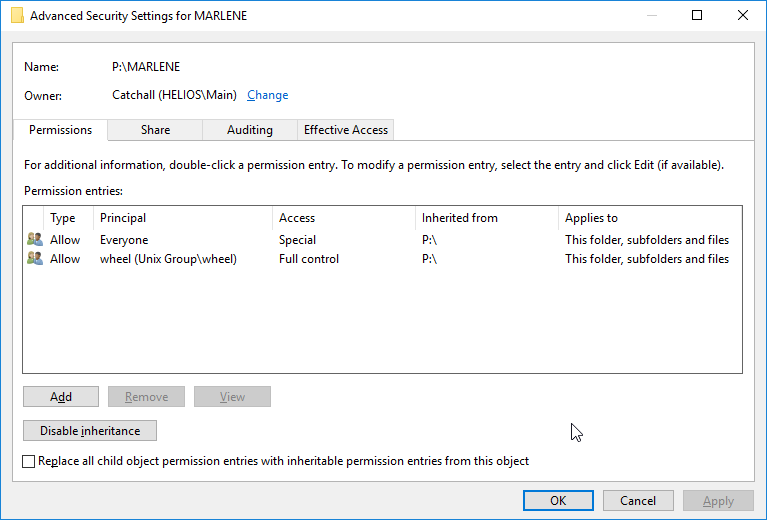

as you can see currently it has inherited permissions from the main share(P: = Main) in order to change this so only marlene has access I would need to remove access by Everyone but since its inherited from the Main share I first need to click "Disable Inheritance" then select "Convert inherited permissions into explicit permissions on this object." this keeps everything as is but removes control over the permissions from the parent directory(so if I changed the parent dir permissions these ones would no longer change)
I then highlight the Everyone row.. and hit Remove

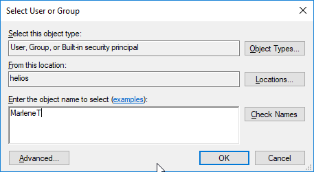

then I hit "Add" and and in the window that pops up I hit "Select a Principal"....
in my case the user(that already exists as a freenas user) is MarleneT so I then type that into the box(seen above) and hit OK

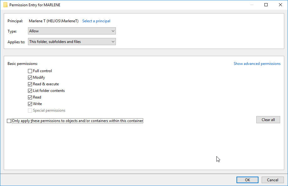

Then I can either give Marlene "Modify" control(almost never give "Full Control") so she can do whatever she wishes to the contents of that folder(but not change its permissions) or read only access so that she can look at everything but not delete/move it.(i often use this for user backup or user specific installers so they have access but cant delete things by accident)
to make this simpler without mistakes you could hit "Clear All" then select either "Modify" or "Read & Execute" which will select everything appropriately(it defaults to read permissions so you could also leave it at that or just check modify)
if you want to know what "Only apply these permissions to objects and/or containers within this container" means look here... https://docs.microsoft.com/en-us/pr.../it-pro/windows-server-2003/cc776140(v=ws.10)
Generally leave it unchecked.
so we gave her access to modify(make her the owner so she can create/rename/delete etc but not change the permissions) then hit OK

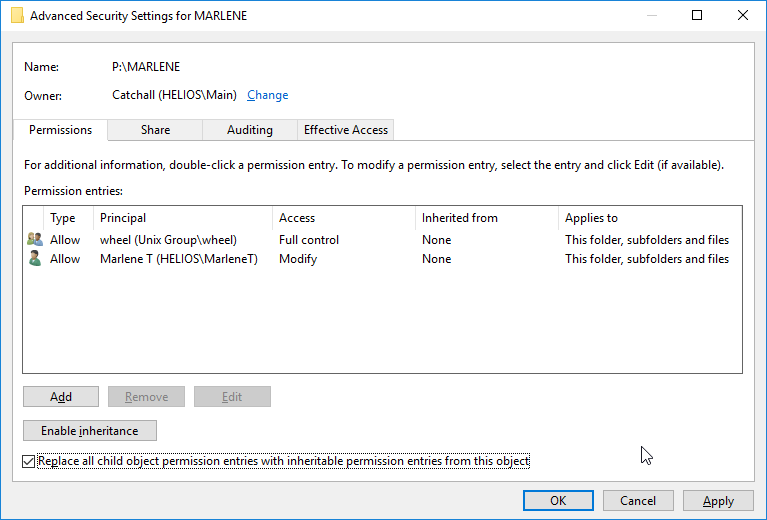

I always check the "Replace all child object permission entries with inheritable...."
So check the box and hit OK
If the warning that pops up scares you then be careful as you could easily undo work you just did if you did the children before the parents.. I always do parents first hence why I always click "Replace all child object permissions"
Yes.. we want to continue.
Then hit OK again... DONE!
now only marlene can open this folder everyone else will be told they cannot.

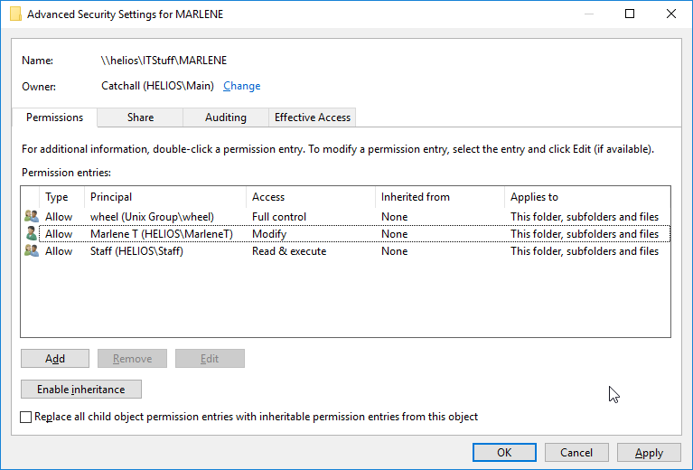

if we wanted to do staff instead of marlene we would have typed in "Staff" instead of marlene or we could add "Staff" and "MarleneT" and set different permissions for both like...
