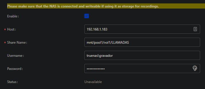

Im trying to use my recent TrueNAS as a storage location for my company calls recordings, but for some reason it's no working, I don't know if someone tried the same before.

That's most certainly not the share name that you should be using and the username is also probably the wrong format.
According to page 356 here: http://www.grandstream.com/sites/default/files/Resources/UCM6300_usermanual.pdf
There's not a lot of information specified about what type of shares they will accept, but I'm going to assume you need to set up an SMB share.
Drop the truenas\ at the start of the username and just use LLAMADAS as the share name (assuming that's the name you give to the SMB share you create(d).
You may also find that you need to enable NTLMv1 Auth and SMB1 if the software is using old versions of the SAMBA client (which would be no surprise).

Did that and nothing changed, but then I also check under Network - Global Configuration and change the hostname to something else and enabled NetBIOS-NS.
Everything is working properly now, thanks for the info man
