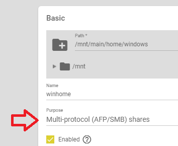

In the SMB service, please enable "Enable Apple SMB2/3 Protocol Extensions".
In the share definition, also enable "Enable Alternate Data Streams", and set the share purpose to "Multi-protocol (AFP/SMB) shares".
Restart the SMB service afterwards.

JWolfe
Feb 5, 2021
16
The corruption you're seeing is due to the Mac OS resource fork not being handled correctly.
Due to my Neophyte status I'm not sure of all of the paths you provided.
I went to Services > SMB > Configure > Advanced Options and enabled the Apple SMB2/3 service.
As far as the share definition goes I went to Sharing > SMB (selected share) > Edit > Advanced Options and enabled Alternate Data Streams.
I don't see anything yet that refers to "Multi-protocol (AFP/SMB) shares"
Samuel Tai
Apr 24, 2020
5,399
Also, as @anodos recommended, add "vfs objects = streams_xattr ixnas" to the share's Auxiliary parameters field. Remember to restart the SMB service after your changes.

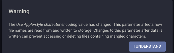

JWolfe
Feb 5, 2021
16
Do I need to move my data out of the share before making this change to Multi-protocol?
As far as restarting the SMB is that done by moving the "running" slider or is it done somewhere else.
Thank you
Samuel Tai
Apr 24, 2020
5,399
So long as you aren't using special characters like é in any of your current files, you won't be affected by the parameter change. However, as all the current files are stored incorrectly, since alternate data streams wasn't enabled, you'll probably need to delete all existing files in the share, and then reload them.
Yes, clicking the slider will change the state of the SMB service.
