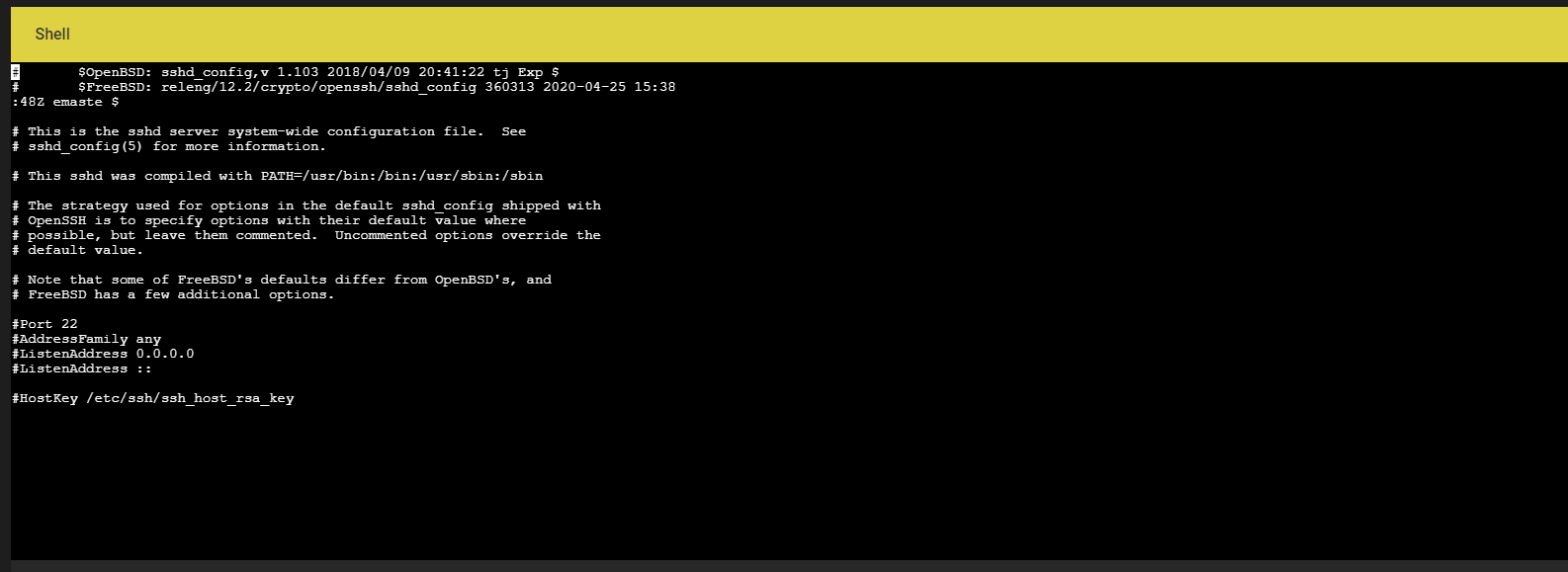

When i do "vi /etc/ssh/sshd_config" i received this message in the shell (attached image)
I can't find PermitRootLogin

You need to do the vi command after the iocage command so you are inside the jail when using vi. The search command in vi is / ... if you are not used to using vi you might try a different editor. Don't know what is on FreeBSD without installing additional packages.
And don't use the web shell. Use ssh to login to your NAS as root, then use the commands I wrote in that order.
