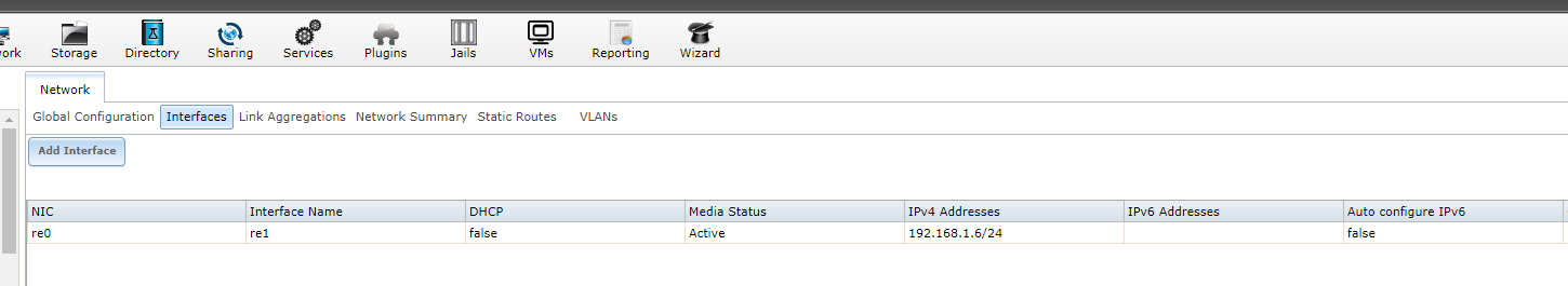

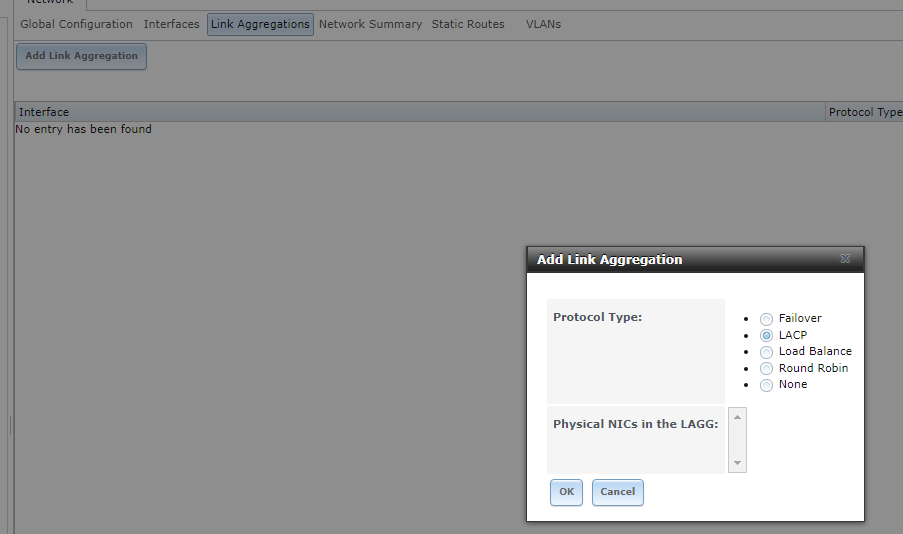

I just added a new NIC to increase transfer speed on my LAN but it is not showing up in FreeNAS(pic). The card I bought was a Ugreen PCI-E PCI E Express:
https://www.aliexpress.com/item/32819991354.html?spm=a2g0s.9042311.0.0.26b84c4dDp3jwo
I just read some threads about compatibility issues but never thought of it at the time of purchase.

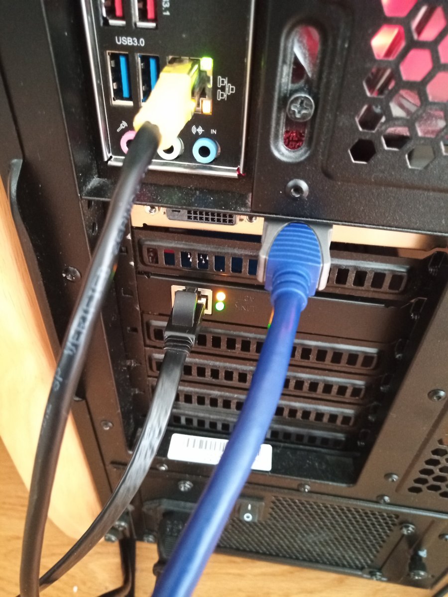

I have the network card in the computer and the network lights are flashing away (pic) so its not broken but as I said it doesn't appear.
I have set a static IP to FreeNAS & piHole because I have mapped drives on my PC to FreeNAS and piHole really needs a static IP - I specified the NIC on the motherboard to do this so maybe I have to set a static IP for the new device? Is there a way I can merge two NIC's to have one IP address?

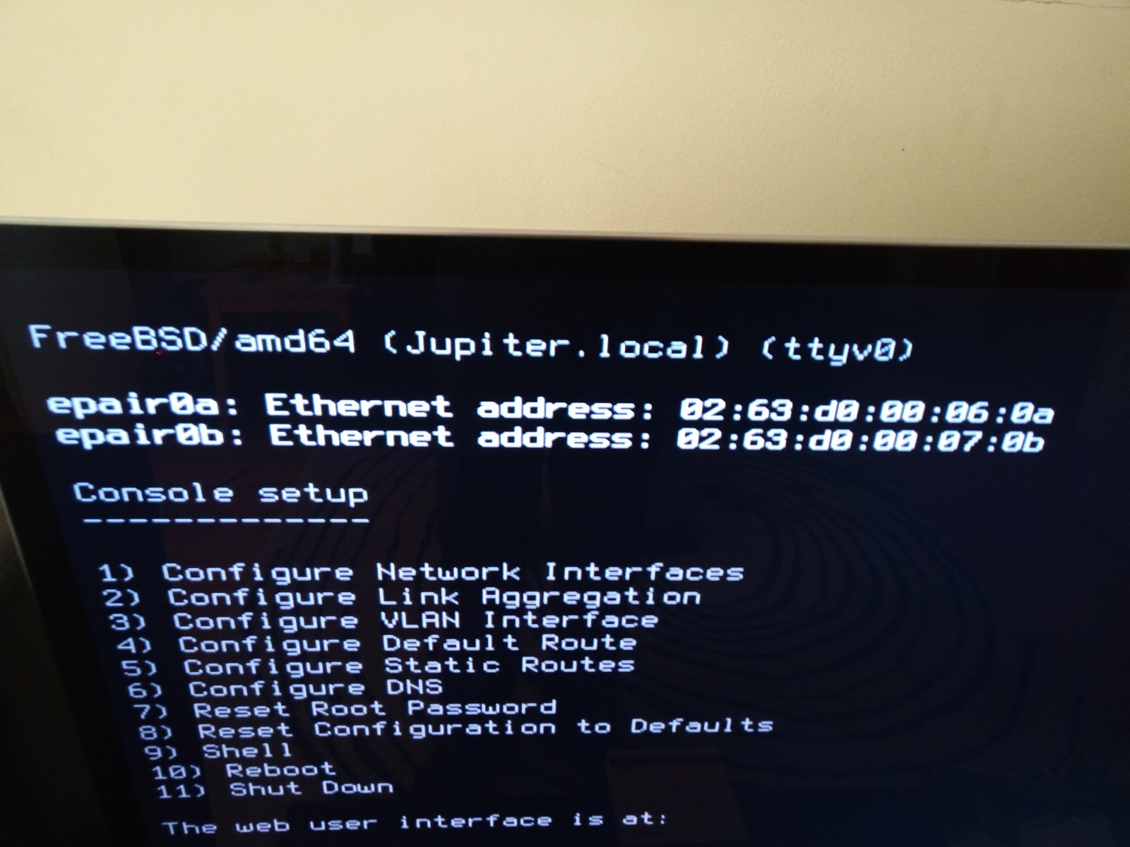

I took a screenshot of the console on FreeNAS after boot, is it recognizing two network cards? epair0a and epair0b ?

aindriu
Sep 6, 2019
18
The NIC is appearing now, The new GUI kind of hid it from me ><.
I'm trying to add these two NIC's together into one link aggregation to increase speed but they don't appear under link aggregation.
I was following this video https://www.youtube.com/watch?v=wqSH_uQSArQ
Why don't they appear under Link Aggregation? How can I make use of the new faster NIC?
