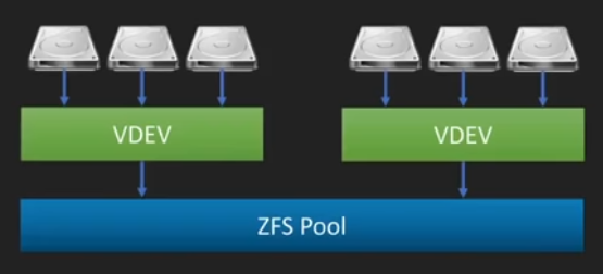

It therefore comes down to goals...if you have 1-year-old 3TB 5,400 RPM drives in the same vdev as 1-year-old 3TB 7,200 RPM drives the speed advantage of the 7,200 RPM drives will be lost, however they're still burning relatively more power than the 5,400 RPM drives. But say you have 5-year-old 7,200 RPM 3TB drives in vdevA and 1-year-old 6TB 5,400 RPM drives in vdevB and you combine them in pool1, things may "pretty much balance out."
ASIDE FOR THE GENERAL READER (not this use-case): If things are "off" you could add more drives to the faster pool and-depending on the layout-it might slow down (or instead add/remove a parity drive), or stripe more drives in the slower pool...it depends on your unique setup and usage, but I think that's getting a bit finicky on particulars and in general "close counts" unless we're talking tiny-datacenter volumes of drives and you're spinning 45+ drives, then taking a closer look might be worth your time.
